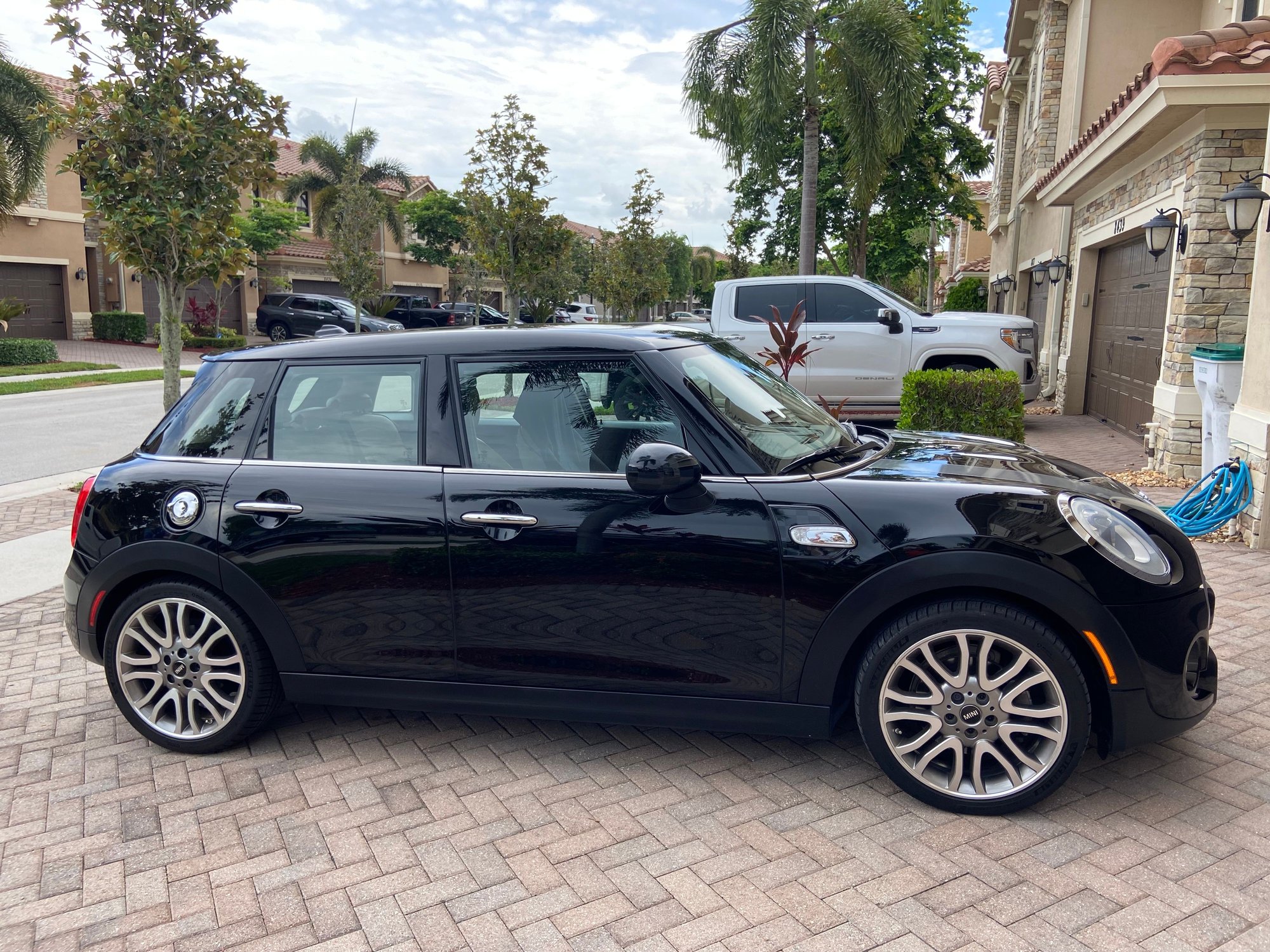

I’m from Spain but have been living in USA for some years, where I bought a 2015 F55 Cooper S as daily.
Now, I have returned to Europe, and brought the MINI with me.
In order to be allowed to register the car, here you have to adapt the lights to EU standards. In the front was ok, in the rear I did the coding for the fog lights (plus change the switch) and changed the tail lights (just the external part)
In the sides, I have to deactivate the side markers on the wheel arches. I want to do it via coding if possible, in order to avoid to have to phisically disconnect them, put resistors, change the wheels arches etc. Plus, my idea is to deactivate them to pass the inspection and then activate them back again (I like my US car being a US car)
I have tried these changes in advance mode (in the electric module)
3-FEM_BODY 3063 MAPPING_SIDEMARKER_L_OUTPUT off fra_v_l
4-FEM_BODY 3063 MAPPING_SIDEMARKER_R_OUTPUT off fra_v_l
With that, I was able to deactivate the front ones, but the rear ones are still active
Does anyone know if it is possible to deactivate both, front and rear side markers?
If yes, I would be greatly grateful if you can point me in the right direction as I really need to do this as soon as possible. The car is now at the shop and they are waiting for me to confirm if I can do it (they don't do this type of coding)
Thank you in advance
Unplugging the side markers is the easiest solution. You do not need to put resistors or change the wheel arches either.
Here's a video showing how to change the side markers which shows how to access the plugs.
Old Sep 9, 2023 | 09:04 AM
  #1046
jbourne's Avatar
jbourne
Joined: Jun 2010
Posts: 333
I know it’s not very helpful, but I did deactivate my side markers on the R56 and the E90 BMW, so I believe it SHOULD be possible, but unsure of the details. Why not pull the bulbs? Or will they fail the car?
(side note, it’s funny how we want the opposite of what we have … I actually managed to find euro fender flares for my North American R56 to get rid of the side markers permanently … lol)
Old Sep 9, 2023 | 11:31 AM
  #1047
Parris's Avatar
Parris
Joined: Sep 2023
Posts: 3
From: Soain
Thank you both for the quick reply.
The “unplugging method” is what the shop wants to do, but that will leave me with two dummy lights on the fenders (unless I change the arches).
My idea, was to be able to deactivate them via software, so I can easily activate them back after the car gets inspected and registered.
I have found a lot of posts of people asking how to activate/deactivate them in F30s, but they always talk only about the front ones.
I think that if it is possible with the front ones, should be also with the rear ones, but who knows…
Thanks again
