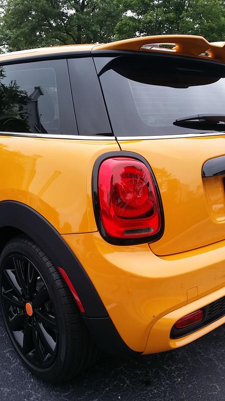

F56 Blackline Tail light bezels installed
Very easy to replace. I used a pry tool and there is 3 "clip" points on each side of the bezel, 1 on top and the bottom has 2 places that slip over a hook.
took all of 10 mins. Enjoy!
So is it just the bezel that comes off or does the whole taillight come off and then you remove the bezel from there?
Old Aug 19, 2014 | 07:36 AM
ItchyPigCreations's Avatar
ItchyPigCreations
Joined: Jun 2014
Posts: 84
Just the bezel

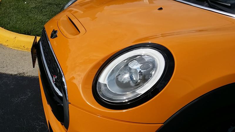

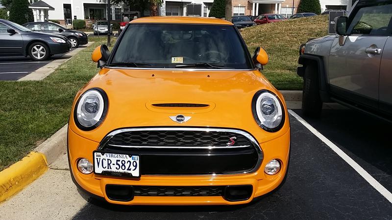

Old Aug 20, 2014 | 03:56 AM
ItchyPigCreations
Joined: Jun 2014
Posts: 84
fronts are complete
