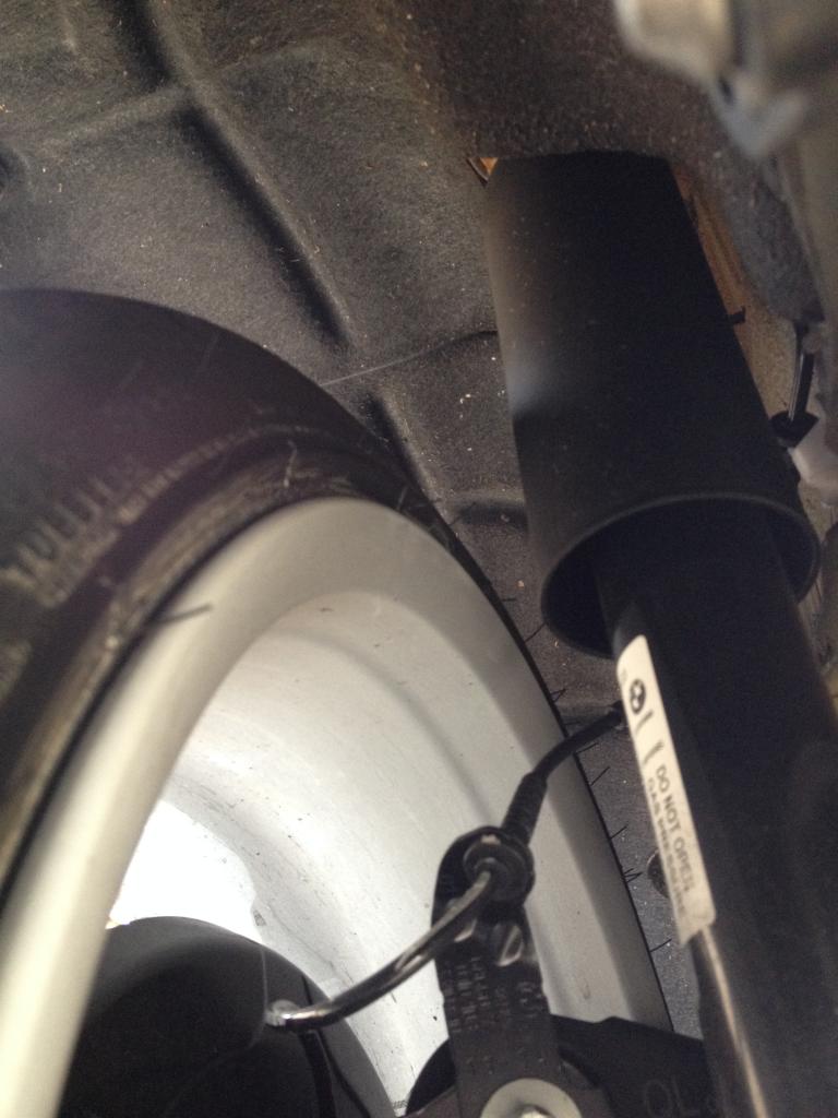

The spacers are probably going to be needed to allow my 18x8 ET45 wheels to clear the struts of my incoming KW coilovers. The current clearance of the OEM struts looks like this:
Front:

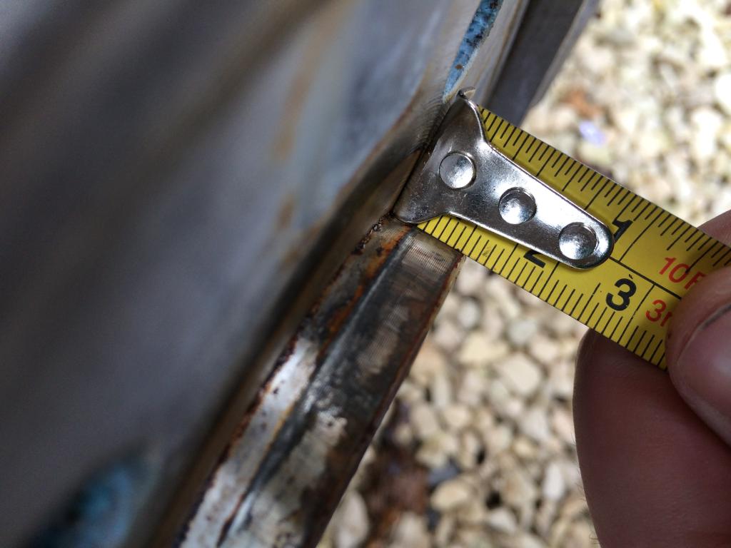

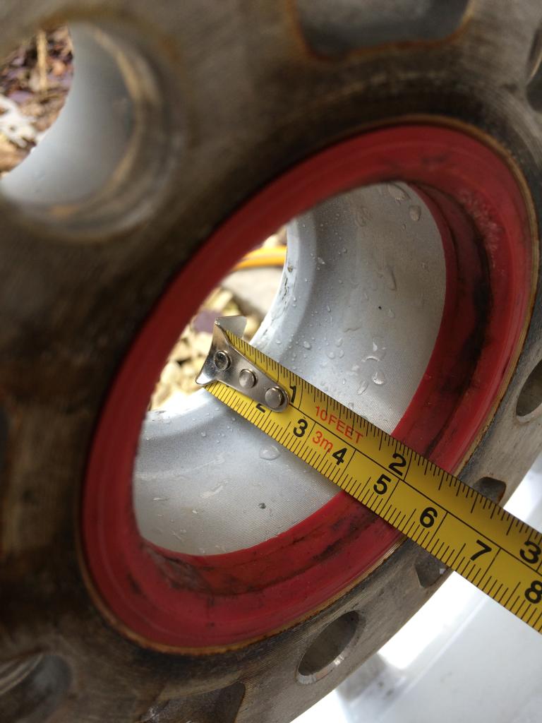

I took a wheel off today and took these measurements (I don't have any caliper a for measuring, only a tape measure!!)
The collar on the hub measures 11mm (from what I can see).
Pictures:
Inside the wheel:
With the above pictures in mind, would a 5mm spacer (with no mounting collar) thus reducing the hubs collar to 6mm be safe to run (with longer bolts of course)??

You need to measure the inside taper on the plastic hub ring as well. That plus the spacer thickness need to be or less than hub flange length minus 3mm.
So say hub flange is 11mm and the hub ring taper is 4mm; then the max spacer would be: 11-3-4= 4mm.
This ensure your wheel to have at least 3mm of contact to the hub flange and avoid any vibration.
This applicable to collar-less spacer.
Old Sep 8, 2014 | 01:25 PM
R99's Avatar
R99
Joined: Jan 2008
Posts: 596
From: Lake District, ENGLAND
You can see that from the photo can't you?
I presume by taper you mean the chamfered edge? If so, that is 5mm, as you can see from the picture, so do you mean:
11mm - 5mm - 3mm = 3mm
Meaning that the max spacer without a collar would be 3mm?
Old Sep 9, 2014 | 06:24 PM
junkart's Avatar
junkart
Joined: Mar 2014
Posts: 74
yes, chamfer. It looks about 5mm like you said. If that is the case then 3mm is pretty much max otherwise the rims won't sit on the flange/collar.
So under the same principal, you can get another set of hub rings with less chamfer so you have more contact surface and get thicker spacers.
