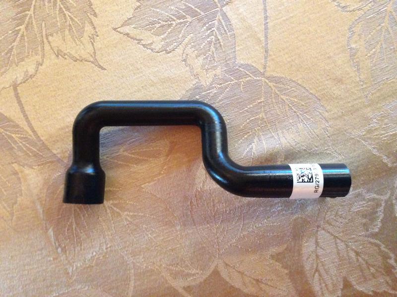

Here are some pictures of my Mini Mystery part. This was found on the floor on the passenger side under the dash board. I don't know when it appeared there as the black on black carpet was near invisible. If I hadn't been cleaning the car it might still be there. I can't say if it fell out from under the dash or was just laying there since delivery or what. It's marked "RG/27973/100" and I can't find it on a Mini Site (eg Sewell) and a Google search finds nothing even remotely close. If anybody has an idea of what this thing might be, I'd like to know.

It looks like the tube that bleeds air into the glove box.
http://www.realoem.com/bmw/showparts...71&hg=51&fg=30
number 12
12 Ventilation hose, glove box 1 51169262368 See NoS No Stock

A round of applause for the correct answer! Nice work hammerhands!

It is a pig to get this to stay in place when you are installing the glove box.
Mine had a small fold on the large end not allowing it to seat properly. This had obviously happened at the factory but it was shoved in anyway. I fixed it when I had my glove box out for the driving lights install.

It is not a big deal and very easy to fix. I can imagine that is tricky to install this part quickly on the line....

Now that this thread has bubbled back to the surface, it begs the question - is there some way to control this bleed air? More - Less? Hotter - Colder? And what the heck do I stick in the glove box that I want at a temperature different from ambient anyway - ham sandwich?

51169262368 #12 There is a valve that sets in the back 51162751723 #11, most of the time its set closed. When you open it and then run the A/C you have a cooled glove box. Goes back to the Gen 1 days .
Most likely it was on too loose and popped off or bumped under the dash.

51169262368 #12 There is a valve that sets in the back #11, most of the time its set closed. When you open it and then run the A/C you have a cooled glove box. Goes back to the Gen 1 days .
So is access to the valve from the insideof the glove box or do you have to reach up from under/behind to change it? (got the truck with me today or I'd go outside and figure it out for myself)

The little valve is accessible through the glove box, its in the back corner. Turn it to close and open.
