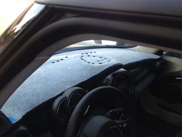

Having been unsuccessful purchasing an F56 dash cover from the regular sources, today we fabricated one.
See post 12 for finished product.

Old Aug 12, 2014 | 05:29 PM
Mrdi's Avatar
Mrdi
Joined: Mar 2014
Posts: 677
From: Surf City CA
Today's rendition.
Doubled, laminated , taped and sewn edges.
The fabric is 1.5 yds. wool felt $9 yd, bias tape $5, spray contact cement $12 , fusible tape $3.
Labor 4-6 hours.
Cheaper than purchasing NO!
However none are available.
We created a paper pattern first.
Cult the felt to match the pattern.
Fine fitted the felt
Cut a second felt
Laminated the two cut felt covers with spray contact cement.
Claudia sewed on the matching cloth tape to the edges.
Punch vent holes with a .........
Yes, a punch.
During Full Fan the cover remains in place.
Attached Thumbnails Dashboard cover-photo-12-.jpg   Dashboard cover-photo-11-.jpg   Dashboard cover-photo-10-.jpg
