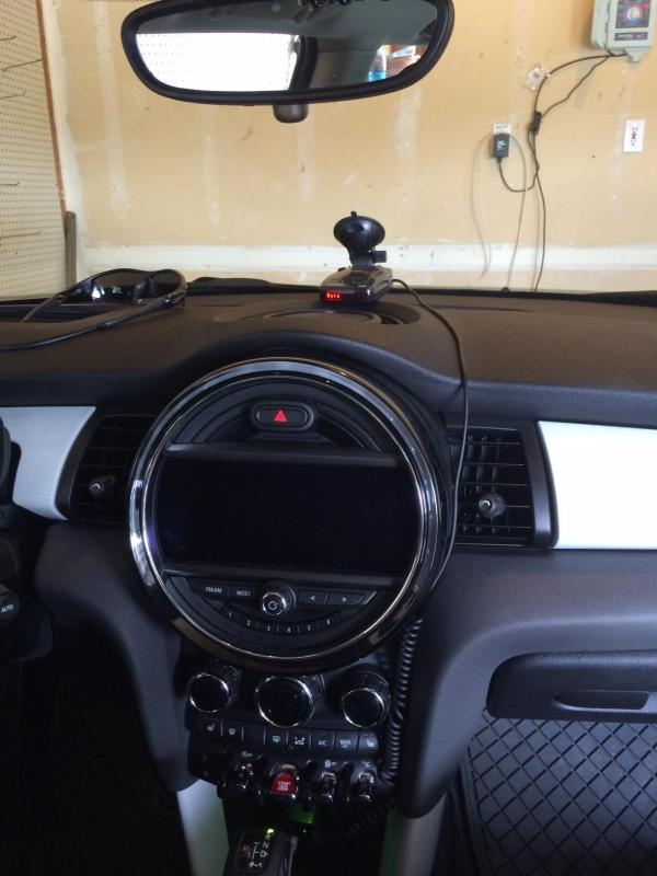

I also went to car toys to schedule a hard wire but then I saw how nicely it fits out of the box. You decide.

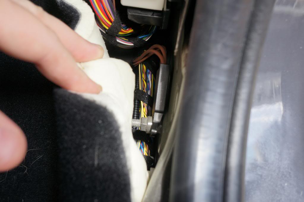

Installing my driving lamps this weekend I found a more stealth method for getting power. There's a threaded power source behind the fuse box. The install is a little more labor intensive, but you won't see anything. Using the grounding point in the passenger footwell I doubt they'll ever notice.

Glucklich, where did you end up grounding exactly? Small screw at the base of the glovebox? Thanks.
It's down on the rocker panel behind the kick panel trim on the passenger side. Go look at my DIY I have posted to give you an idea of how to get to it.
