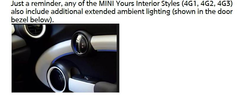

We can confirm that the extended lighting is only included with MINI Yours Interior Style 4G1, 4G2 AND 4G3.
Please see the attached snippet from MINI's latest bulletin.

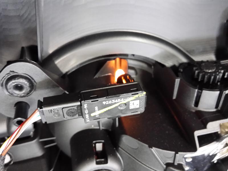

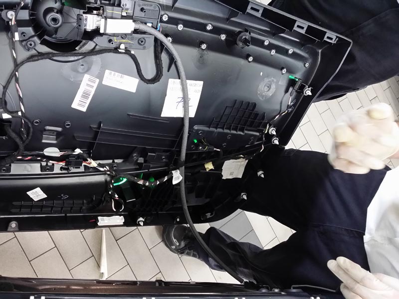

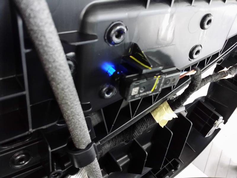

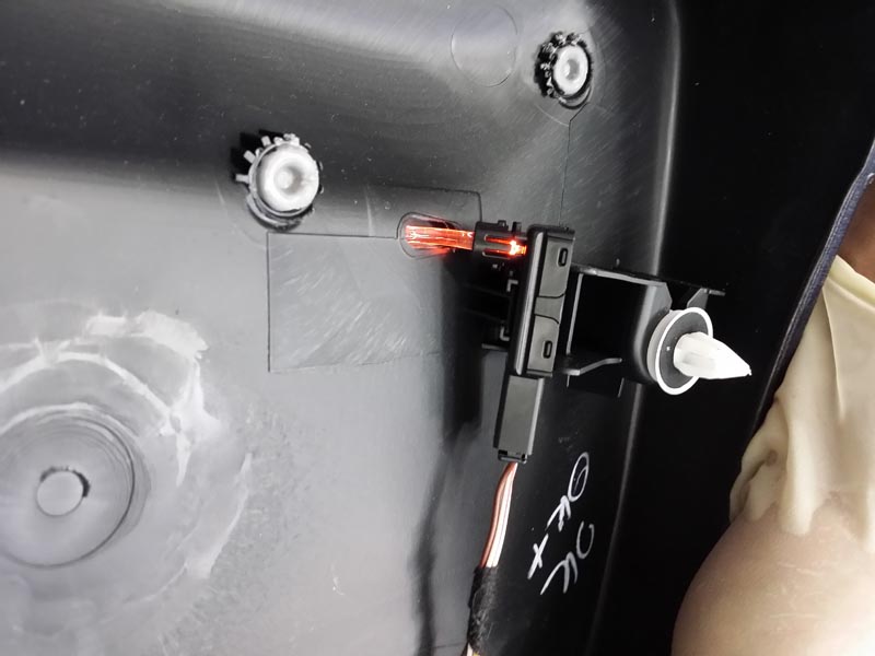

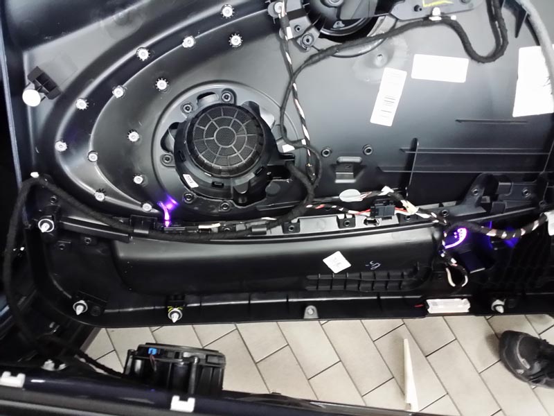

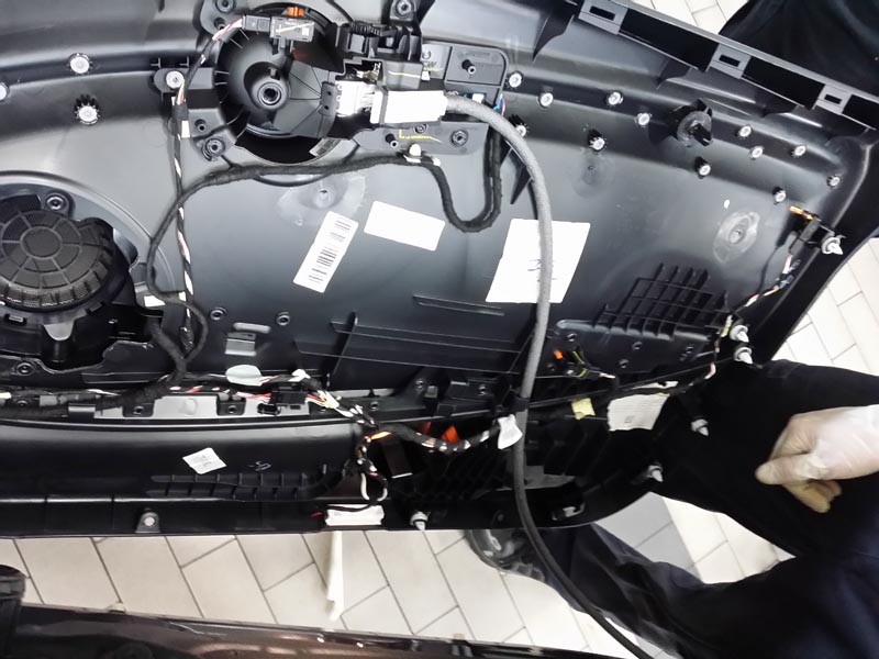

Adding LED lighting to my 2016 F56
I can indeed confirm that there are THREE additional wiring connections for LED lighting in my door panels. I had already bought the piano black trim pieces with the led light bars to add to my doors when I discovered there is also a place for led lighting for the door pocket as well so after taking off my passenger door and drilling 20+ holes and adding all the lights and connectors and trim pieces I have now ordered the additional optical connectors for my doors and 2 more led modules from outmotoring. I have added some photos of where I am at thus far on this project.
front trim piece with connectors
back trim piece with connectors
New led module for front trim piece by speaker
front trim piece with connectors and led module
where the led light for the door pocket goes.
Old May 11, 2021 | 03:31 PM
bgdrewsif's Avatar
bgdrewsif
Joined: Apr 2016
Posts: 146
From: Upper Sandusky, Ohio, USA

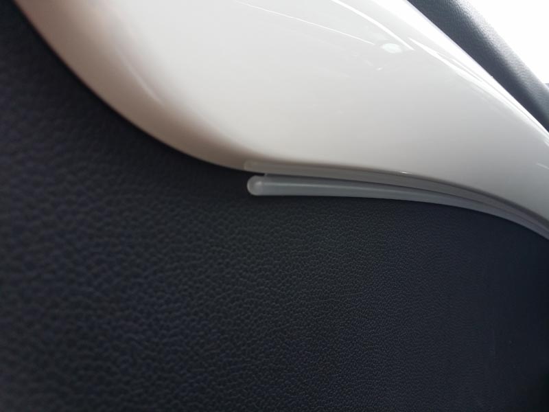

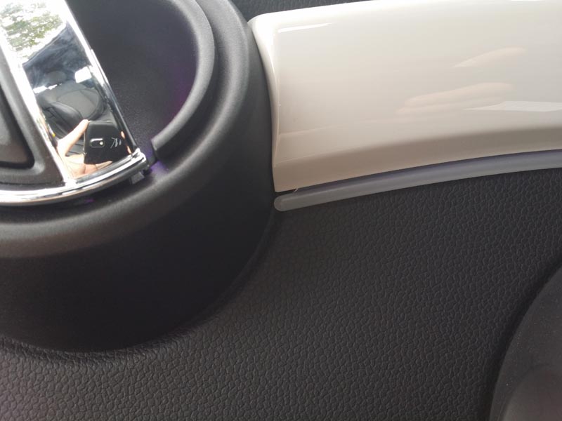

More pics
I also took the trim pieces for the door handle covers and the speaker covers to a local auto body shop and had them professionally painted gloss black to match the new Piano Black door trim pieces and they turned out GREAT. They are an exact match for the OEM piano black finish. I also had the trim pieces for my HUD, center USB/12v, and i-drive controller painted to match them also as I didn't want to just have some stick-on trim covers for those. I do apologize for all the dust and fingerprints but I figure no sense in cleaning them until I am actually finished...
Door panel finally installed and lit up in the daytime
And lit up at night
