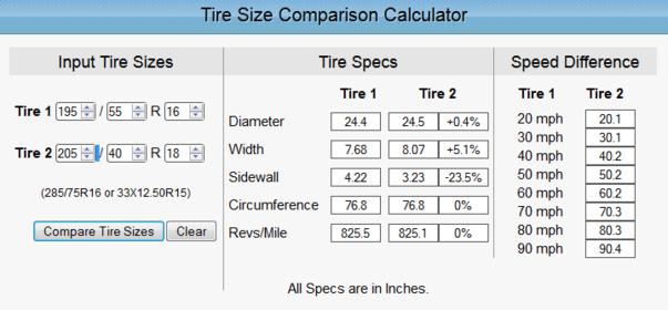

champ198. Black 17" with a Grey car....funnily when you use the tool I posted the 18" with the 40's are smaller than the 16 55's.
You better find another tool ...
Lowering does not solve the problem. The wheels look too small imo. If I lower the car...It will look like a lowered car with small wheels.
Putting inappropriately oversized tires on wheels will not make the wheels look bigger.
Your best bet is to fit 18" wheels with 215/40-18 tires.

Miniac. Not following your logic mate. Putting slightly bigger ties on the rims will make them look bigger....because they will be bigger. A one 1" taller tire....will be 1" bigger and therefore look bigger.....right? The difference in the roll out speaks to that. The 3mph difference in the speedo could probably be addressed.
As you have demonstrated the outside size of the 18's and 16's are the same so the gap will remain the same = big :-)
