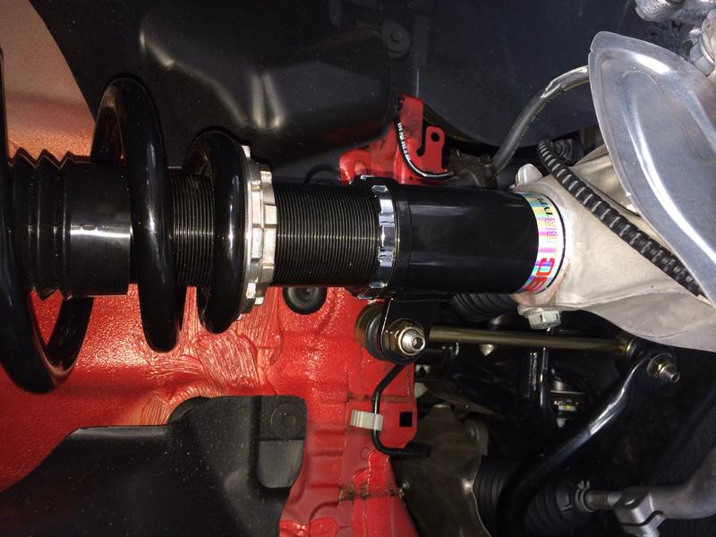

Got mine installed today. Overall very happy. The bc kit installs no issues and is pretty straight farward. No drilling or modification of any bodywork or stock suspension parts.
Overall, the ride is definitely a bit stiffer. I would say it is more bouncy than anything, it's not very harsh over bumps and rough roads however. I think I need to play with the dampening a bit, may need I be set stiffer to match the springs rates.
I haven't played with the height much, I'll do that later when I install my new wheels. It's maybe an inch to 1.5 inches lower right now. Drove it hard without rubbing. Handles much better over standard suspension, feels like it's on rails with very little body roll.
I'm running 5mm spacers front an rear. The rears clear fine but I just added then to match. I actually got the front on without spacers but the clearance was very close so I figured I would run the spacers to be safe.
Only thing is with 5mm spacers and stock wheels the collars from the hub barely (if at all) connect with the wheel. Luckily the stock bolts are conical so I'm not getting vibration or anything. Just not sure how safe it is to run like this? Anyone with more knowledge care to chime in?
The stock collars are like 10mm at least but the stock wheels centerboard tapers in over about a 5mm area.

More

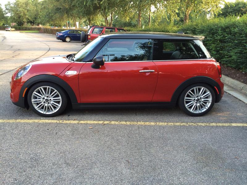

I installed my BC Coilovers last weekend and am very pleased with the handling and looks. The installation was pretty straightforward, but still an all-day event. I ended up raising the car and removing the wheels four times before getting the correct ride height.
After trying a few different ride heights, I finally settled on a 1-inch drop front and rear. Only a little bit noticeable drop, but it suited my taste.
A damping setting of 13-clicks out from the stiffest setting gave me a stable ride without being too harsh. The car feels much more connected to the road, and has no bounciness or a rolling-over feeling during fast cornering. Road bumps and roughness are definitely more noticeable than before, but I like that feeling. Adjusting the front damper settings is easily done under the hood. The rears are a bit harder, and requires jacking up the car a few inches to reach over the tires to access the adjusters. Adjusting all four corners takes about 5-10 minutes. Ride height adjustment takes much more time, and requires wheel removal.
On Monday I took the car in for a wheel alignment. I was told that the camber was barely within spec. Any lower than a 1-inch drop would have put the camber out of spec. Interesting that the rear wheel alignment was out of spec and the front alignments were just within spec. The car has about only 5000 miles on it and I've never hit any big potholes, but the shop said its common for new cars to be delivered with mediocre alignments.
The instructions that came in the box were pretty vague. I'd suggest searching YouTube for tips on spring pre-load, installation, and adjustment. Especially review installation for the rear's which have separate shocks and springs. [http://www.infinitig37.com/infiniti-...oilovers.html] provides installation instructions for BC's on an Infinity, which has a somewhat similar rear suspension.
Kevin.

Old Sep 27, 2014 | 04:33 PM
  #139
kevinm's Avatar
kevinm
Joined: Feb 2014
Posts: 19
From: San Diego, CA
Lowered 1-inch. Kevin.
