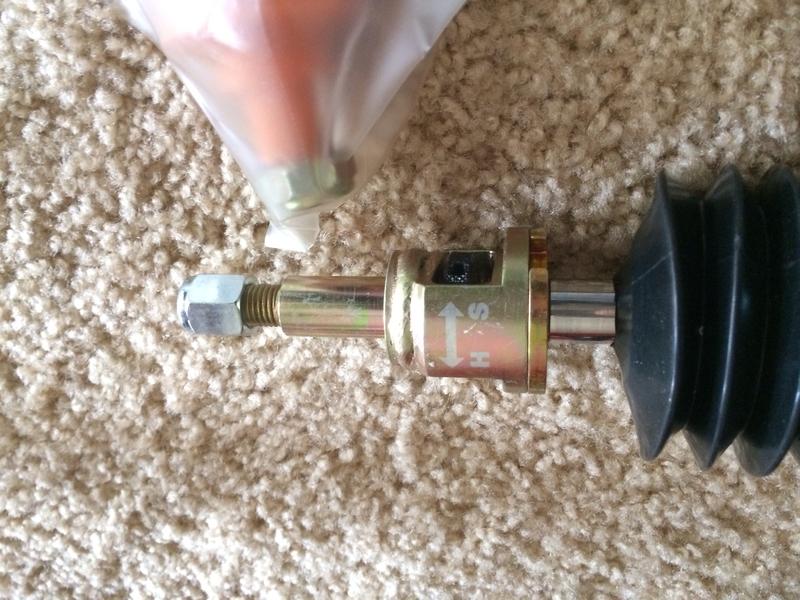

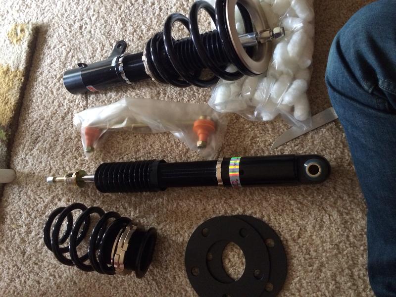

Got my coil overs today. Overall the lot looks good. Only thing I don't like is the width of the front dampers, they seem wider than they could be so I can see why they need 5mm spacers. However the kit comes with 5mm spacers for the front, rear does not require spacers but I'm going to use them anyways so it's not out of whack.
Looks like you reuse your top mounts on the front and the rear. Kit also comes with new swaybar endlinks for the front.

Only letting me post one pic at a time sorry (on my phone)

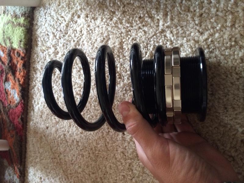

More

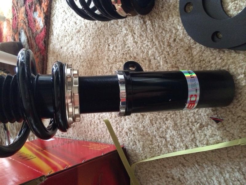

Front damper

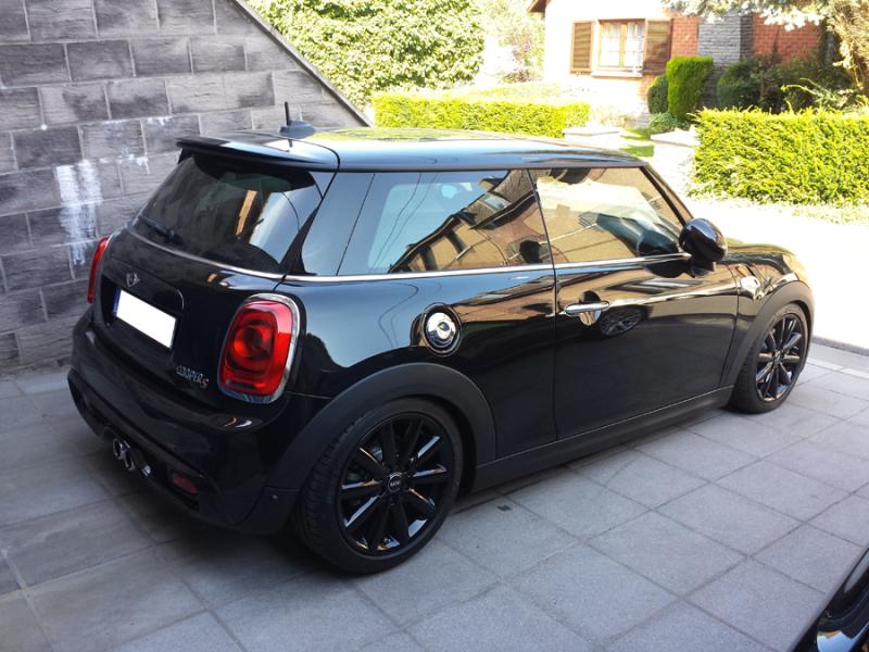

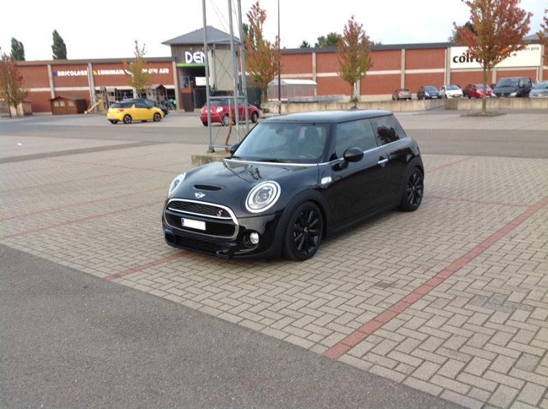

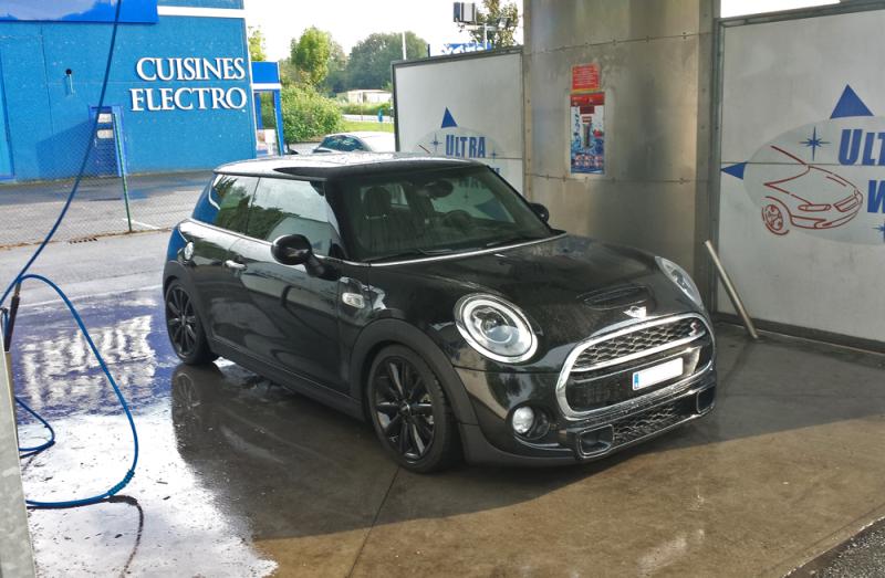

KW have delivered the goods!
Not my car, but a guy from Belgium
My set arrives on the 26th - I can't wait now Ive seen these pics!
The good news is that he also says he has about 10mm of clearance against the struts with his OEM wheels fitted too, which is good news for my 18x8 ET45 set up and 205/40 18 tyres.
The bad news is that his 18x8 ET35 wheels (with 215/40 18) are too aggressive against the wheel arches, so he is having to have his milled down to make them ET45. Heres a pic of his wheels on before the milling.

the angle of those pics is awkward but definitely lower than the previous pics in this thread of the H&R springs. I'm looking forward to more pics, especially a straight on side profile. And I can't be the only one who doesn't think those et35 wheels are too aggressive.
Also, milling 10mm off those wheels could very well reduce the structural integrity depending on how they're made.

Coilovers won't get stiffer when you go lower, unless you go so low you are hitting the rubber bumpstop. And to avoid that, many coilovers have the lower body threaded as well, so you can adjust ride height without changing the available travel. That's ideal. Looks like the BC have that feature, but KW don't, although that's not to say anything about the design or quality of either brand.
