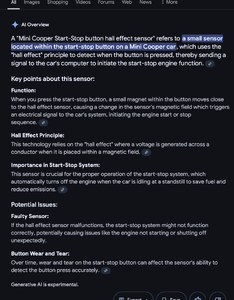

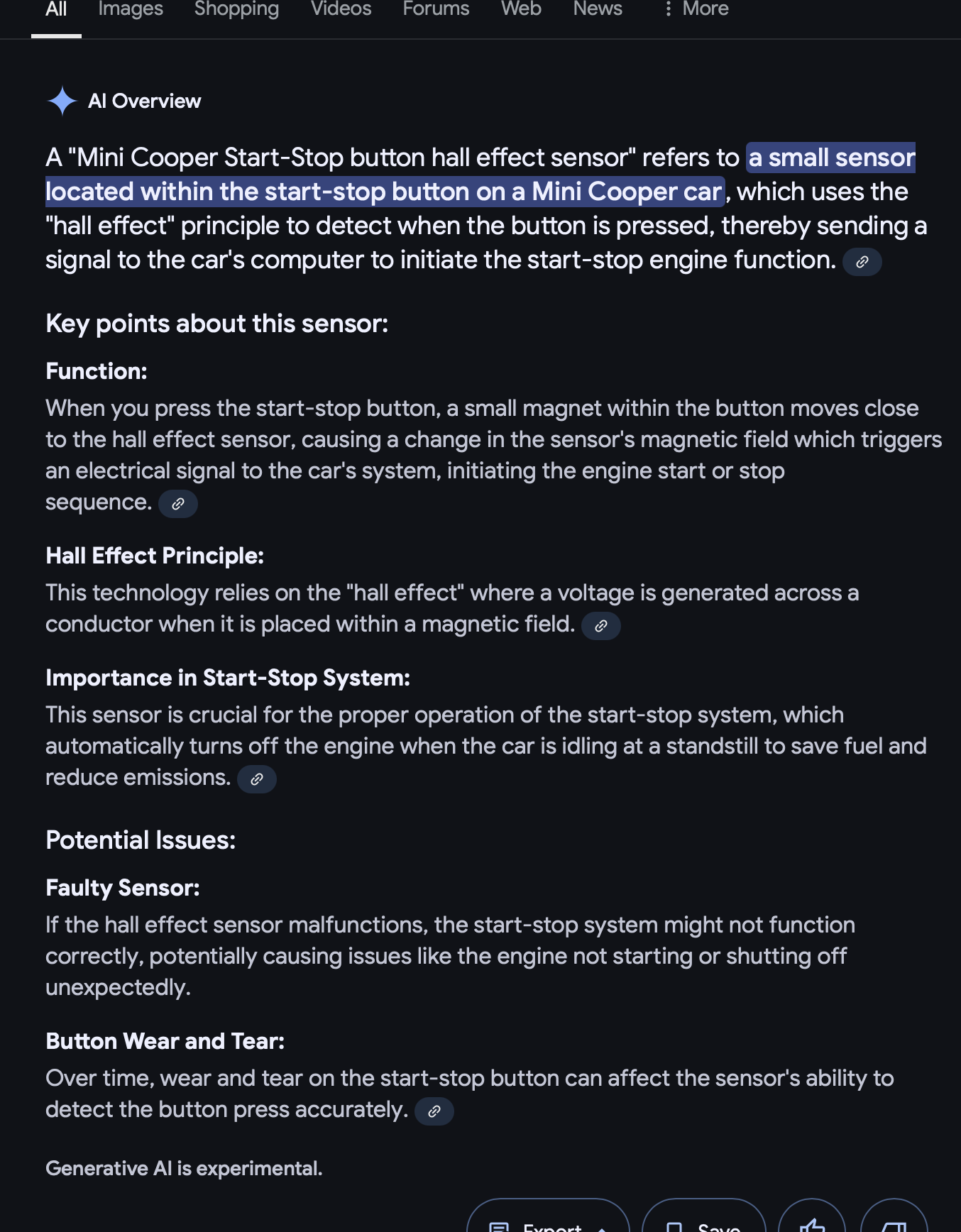

I recently did a trans swap (took out my S trans and swapped in a JCW unit) and replaced all mounts. Somehow in that, I took a perfectly working/starting car and now it will not start on its own. After doing some testing to verify ground is good in a variety of places (trans ground strap, battery, starter) and verifying that if the starter terminals are jumped and you press the start button it starts and runs perfectly! So it's localized to the start/stop circuit. When I look at live values on the Autel, I see everything works during startup EXCEPT Terminal 50 never excites which is the power feed for starting. The clutch pedal and brake pedal switches have been confirmed to be active (they show live data when pressed/depressed). I did see these codes and this is the info I found on them.
