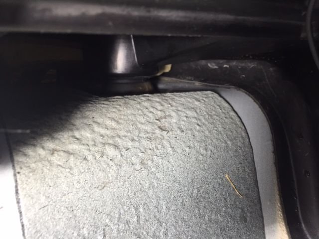

Sorry for all these posts but I'm using it as documentation for the next guy too
I just went out and pulled the whole carpet back from the passenger side and took a picture.
Is this drain from the top side for the A/C? I just want to make sure it's attached on this side before I suck out the mess from the bottom. I pulled this whole piece last year as well because I had to fix the linkage in the auto climate control system. That was a nightmare.
Thanks!

Old Jun 13, 2016 | 07:32 AM
takrdown's Avatar
takrdown
Joined: May 2007
Posts: 361
Likes: 32
From: Central, CT
Thanks!
Anyone have any insight on this one before it gets lost in the thread? I found the drain on the underside next to the cat and it looked bone dry but when I took a shopvac to it nothing came out. Can't for the life of me find the leak.
Old Jun 13, 2016 | 08:05 AM
Posts: 36,758
Likes: 2,548
The drain you can get from here for the A/C. Most people just get it from the bottoma dn make sure its not clogged , it get to the better you would have to go under nith and remove the exhaust heat shield and reach up.

I saw this thread yesterday and was hoping and praying i would get the spigot this guy got lol. I may just remove the heat shield and see what's up. I'm just hoping I'm onto the right track.
Removing the climate control brick under the dash is just out of the question. I've done it once before and that involves removing the whole dash, draining coolant, and draining the a/c system.
