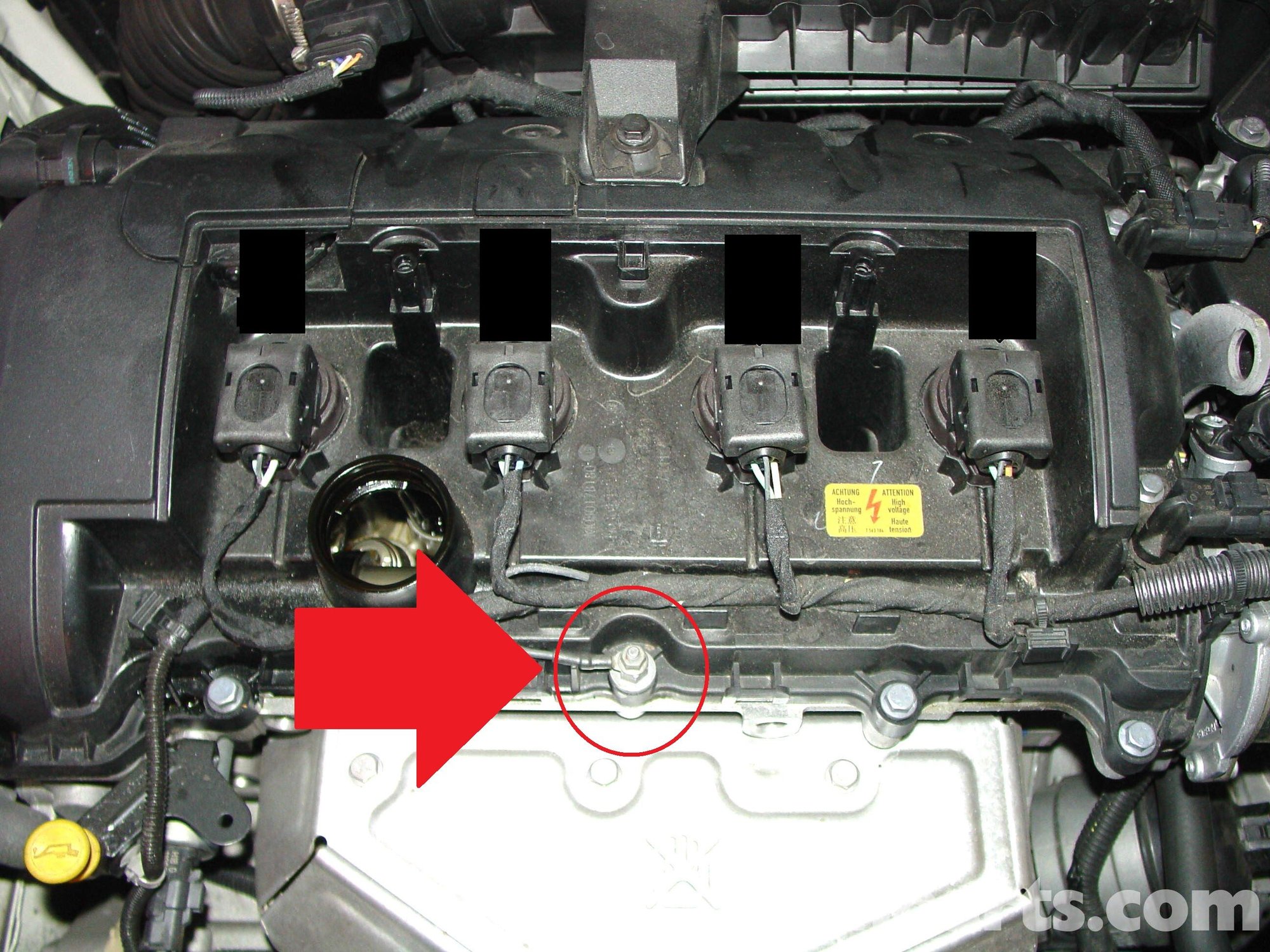

Just saw this thread and wanted to add:
There is (at least?) one more engine ground which if disconnected will not let the car start (without any dash lights coming on). It is located at the middle one of the front bolts around the valve cover. A small, easily overlooked wire (out of the harness lying just in front of the valve cover) extends to it. In order to see this bolt and the wire to it, the spark plug and coil cover must be removed (at least on my 2010 base Cooper LCI with the N16 engine and automatic transmission).
Edit:
Found a picture on the web and indicated the bolt in question.
(source of the picture)
