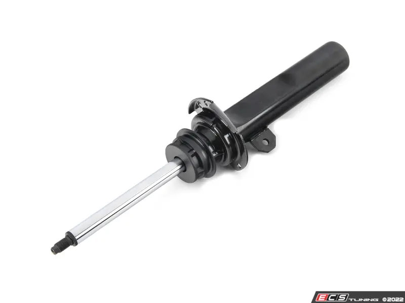

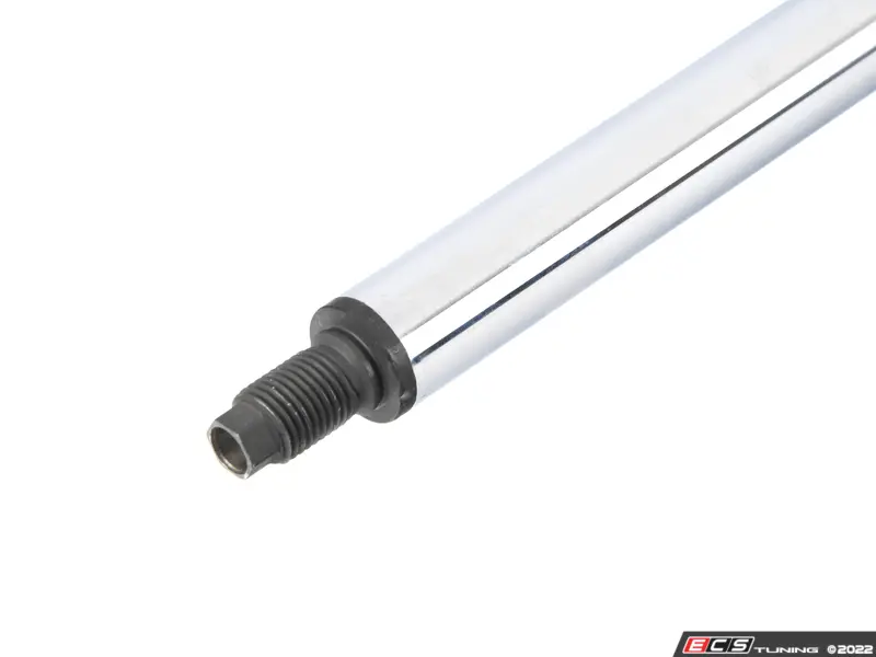

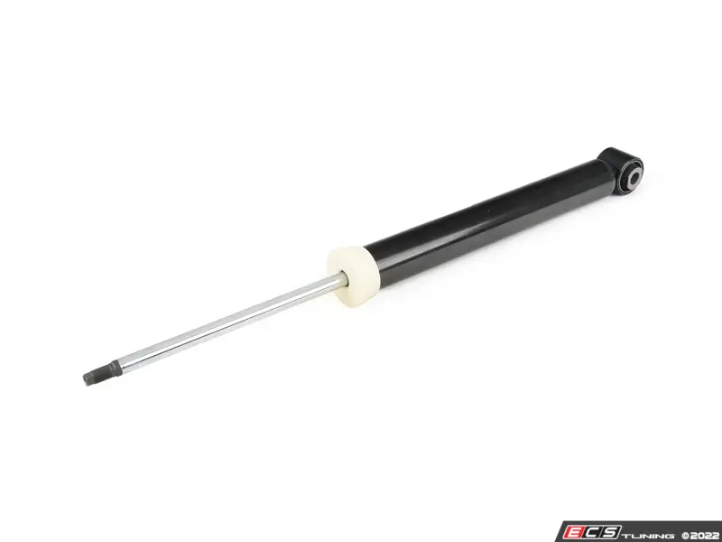

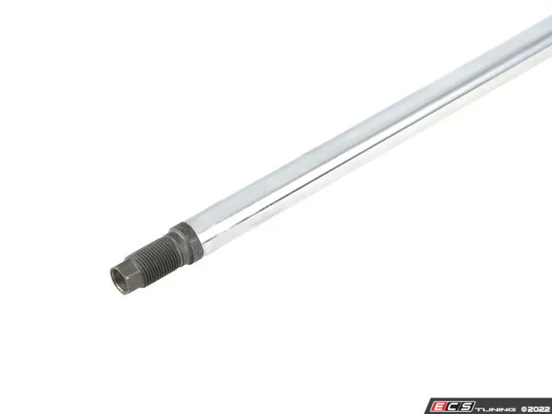

Variable Dampening Control shocks pre 2024 have the additional larger Pin size and different part number mounts.
They connect a little wire to the top of the strut. Everything else is the same as a standard MINI shock on the outside.
Also called EDC or DDC.
Front shock set up:
