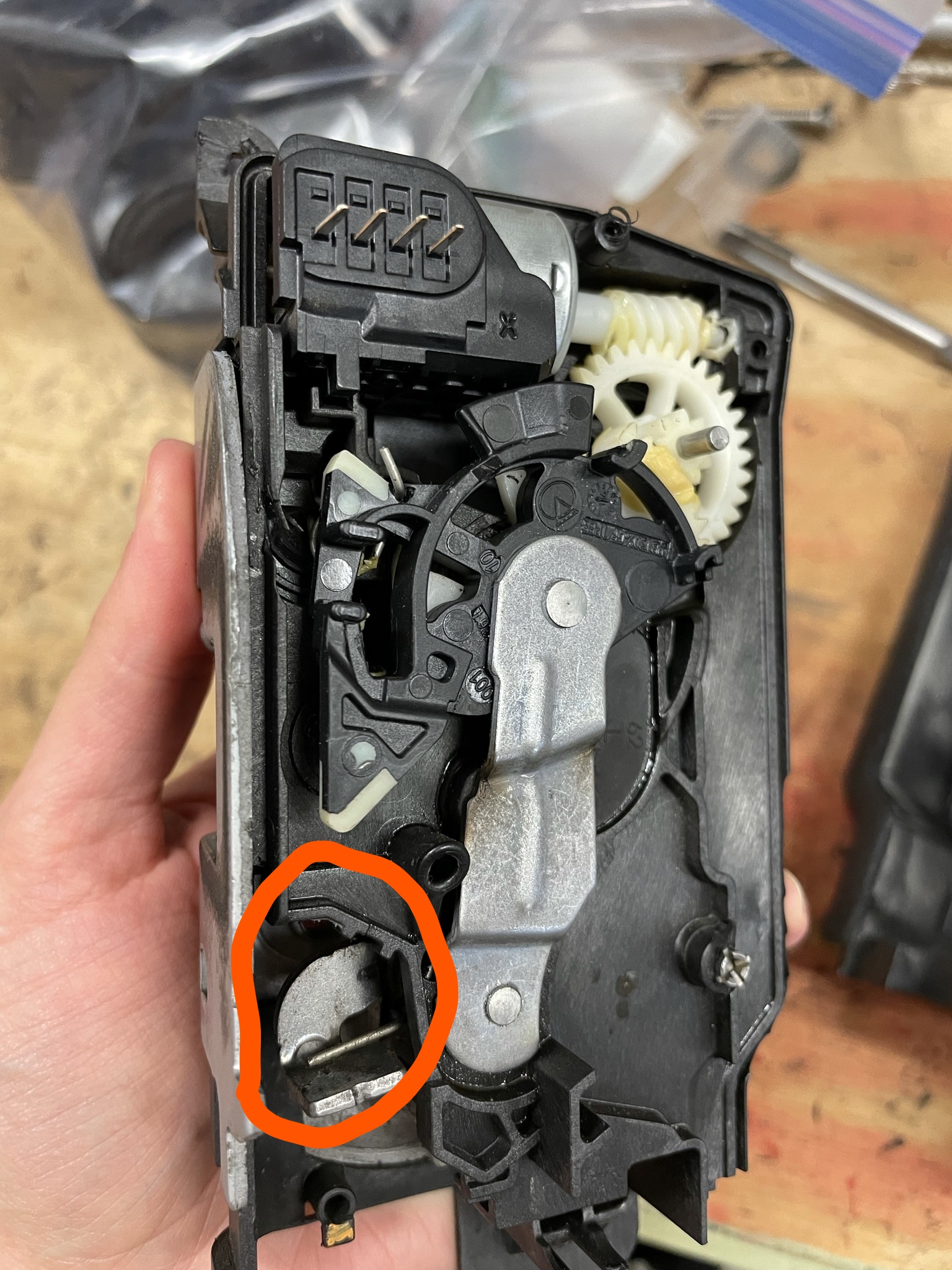

Out of curiosity I opened up the latch system.
Photo #1: For reference, the door latch is right below my thumb on the photo below. The red circled area might be the part of the actuator that ain't actuating. It won't engage the lock mechanism when I was fiddling with it.
Photo #2: The opened latch system with internals exposed. Awfully big and complicated for a piece I've never really thought about before.
Still waiting on the replacement latch. Hopefully will have it delivered and get it installed tomorrow night.
