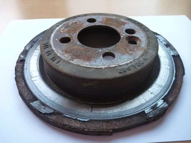

I guess it's not really relevant but I like this photo of one of my rear rotors, showing a bit of wear. Surprisingly, there wasn't much evidence of this when driving, though it explained some of the clunks when setting off on a Monday morning when I hadn't used the car for the weekend - not pads releasing from the rotor, but the surface of the rotor coming away!
Hands up any children who can tell that roads are salted here in winter...
My rears on my 2005 started to flake on the edges replaced them at about 4 years..failed the yearly inspection.......salts and the the MAG-Chloride, etc substitutes are hard on parts...
But yours..OUCH...look like they were a couple years overdue!!
