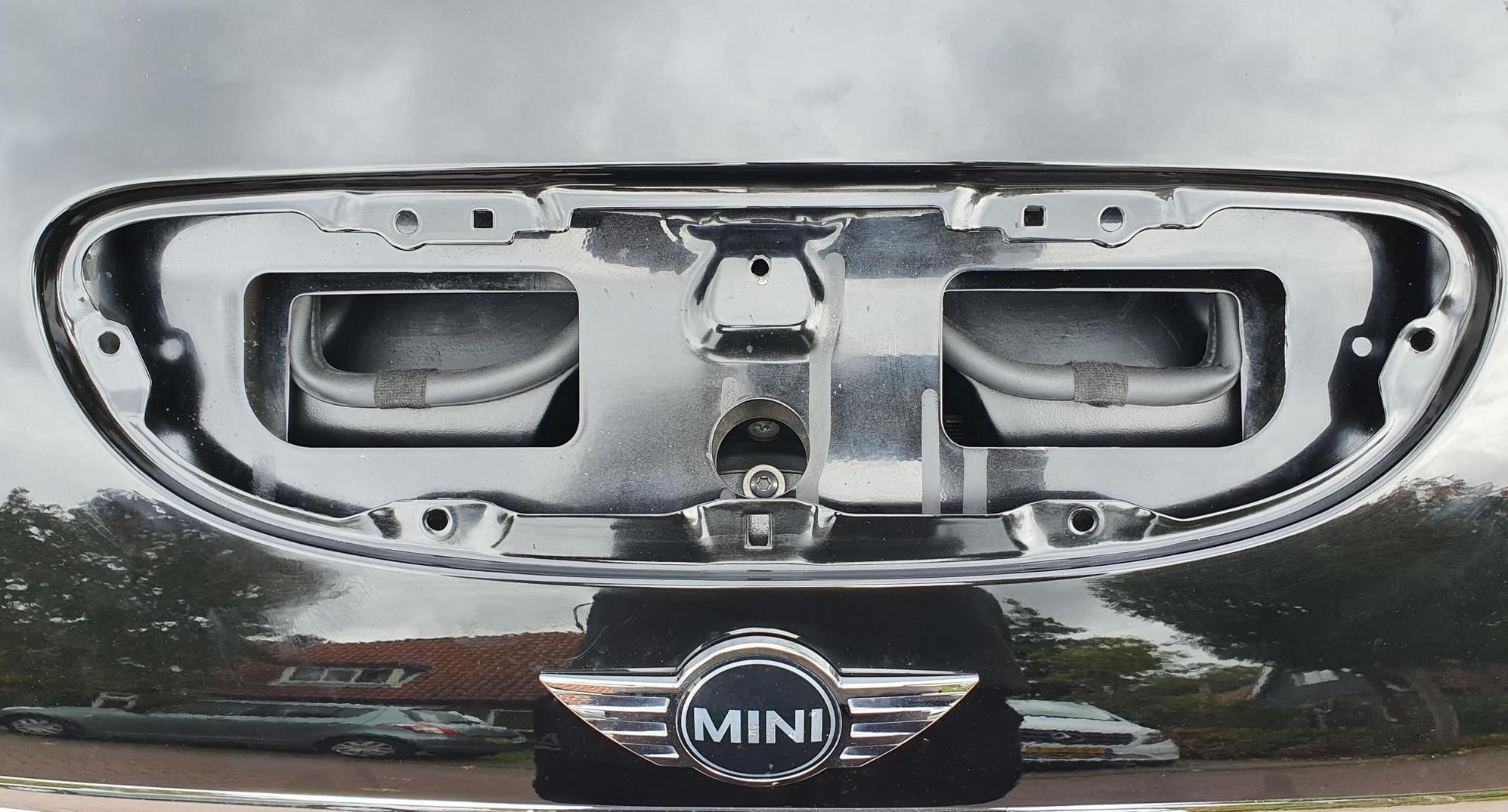

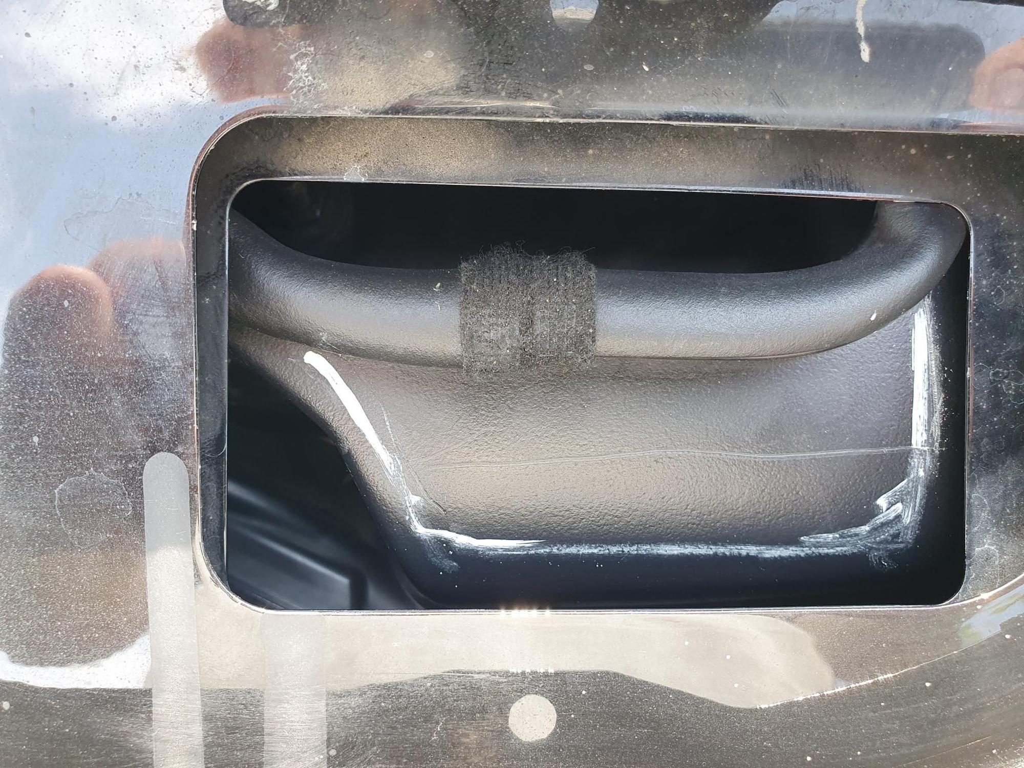

I could not leave this alone and had to check the fitting on my Clubman. My Eventuri intake is also the plastic version, it was installed last September and to my surprise the holes through the hood scoop do not line up with the plastic intake on top of the radiator!
Frghu was right and I apologize to him for my train of thought.
The pictures attached were taken from above with the bonnet closed after removal of the hood scoop so that I could see how much the corresponding holes were off….
I will probably Mc Gyver the system and line up the holes tomorrow.
Eventuri is going to get an extensive complain letter from me!
Left side hole as seen through the bonnet
Right side

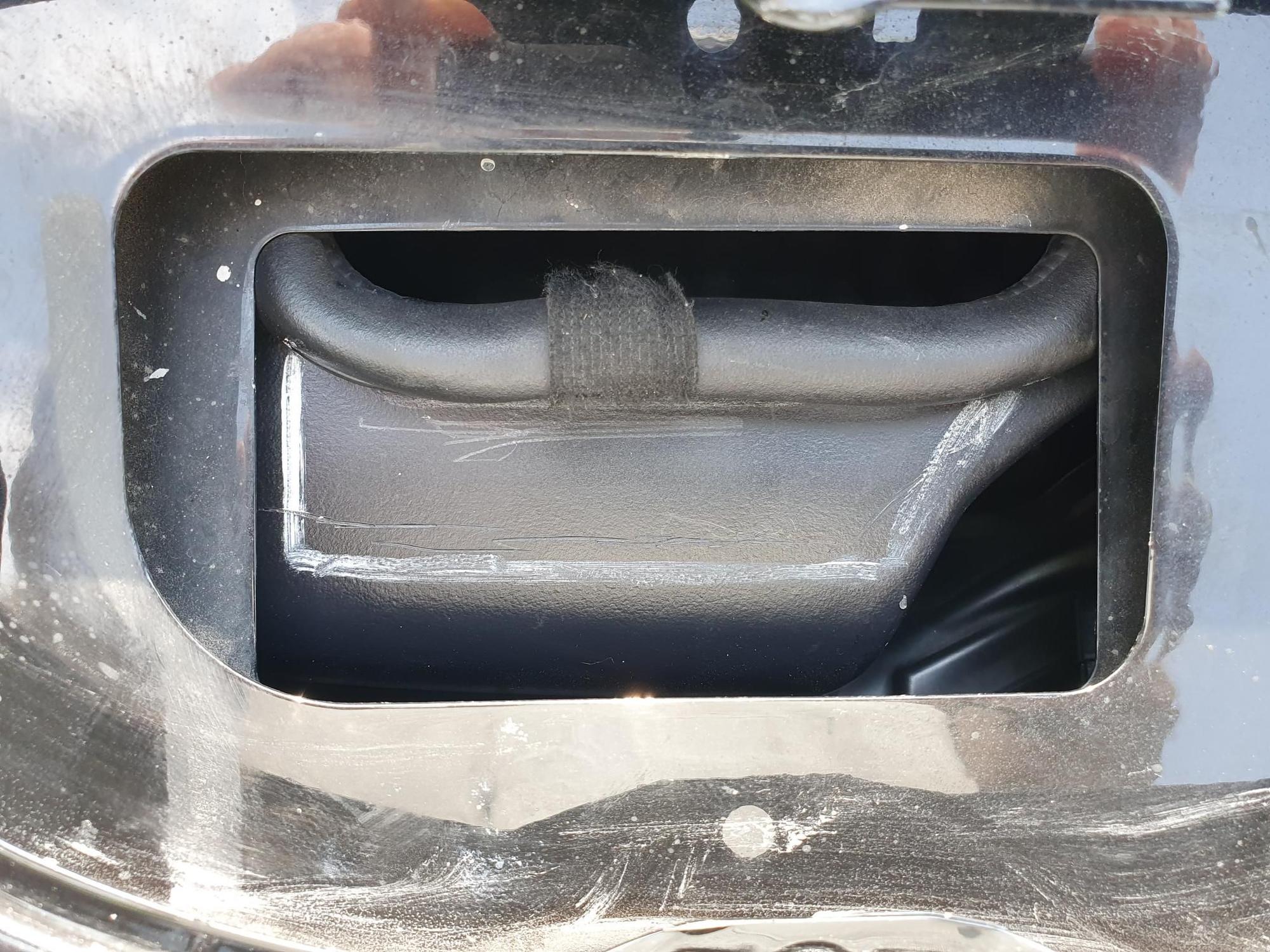

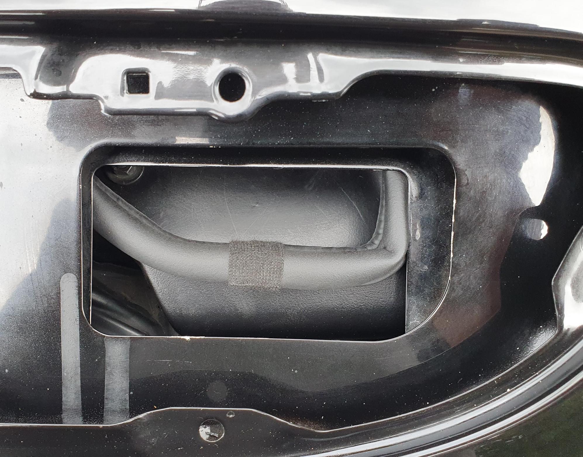

Dear All,
Eventuri came through and sent me an updated Pre-LCI front duct manifold for my MINI F54 Clubman. The holes line up a little bit better, but in my opinion, there is still room for improvement.
I Mc Gyver'd the original duct manifold and cut the holes up to the white lines in the previous pictures. I just installed the new manifold and will see if it makes any difference.
