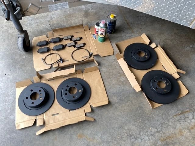

I finally got my new brakes and hardware installed ~2 weeks ago and have a couple hundred miles on them, as my F54 is a daily driver. The new rotors, pads and sensors are working great! Pedal modulation is very much like stock when doing 'normal' braking and you can tell that the Z23 pad compound has additional 'bite' when you need to instituted a quicker than expected brake maneuver. This reflects my use of the front Z23 pads for a track day back in 2018...which was before Power Stop had the rear Z23 pads available. The Raybestos rotors stop true and w/o any pedal vibration. I am also pleased with the amount of dust the Z23's put out, certainly less than the OEM pads toward the end of their life!
Here are some pics of my additional coat of caliper paint on the non-wear surfaces of the rotors along with some install pics. I use the Ford Motorcraft nickel based anti-seize on all fastener threads and the Permatex Ultra Disc Brake Caliper Lube on all sliding surfaces. The lovely mid-west road salt in the winter does a great job crusting things up, so I always make sure to wire wheel/abrade the sliding surfaces before applying a thin coat of the Permatex lube.
