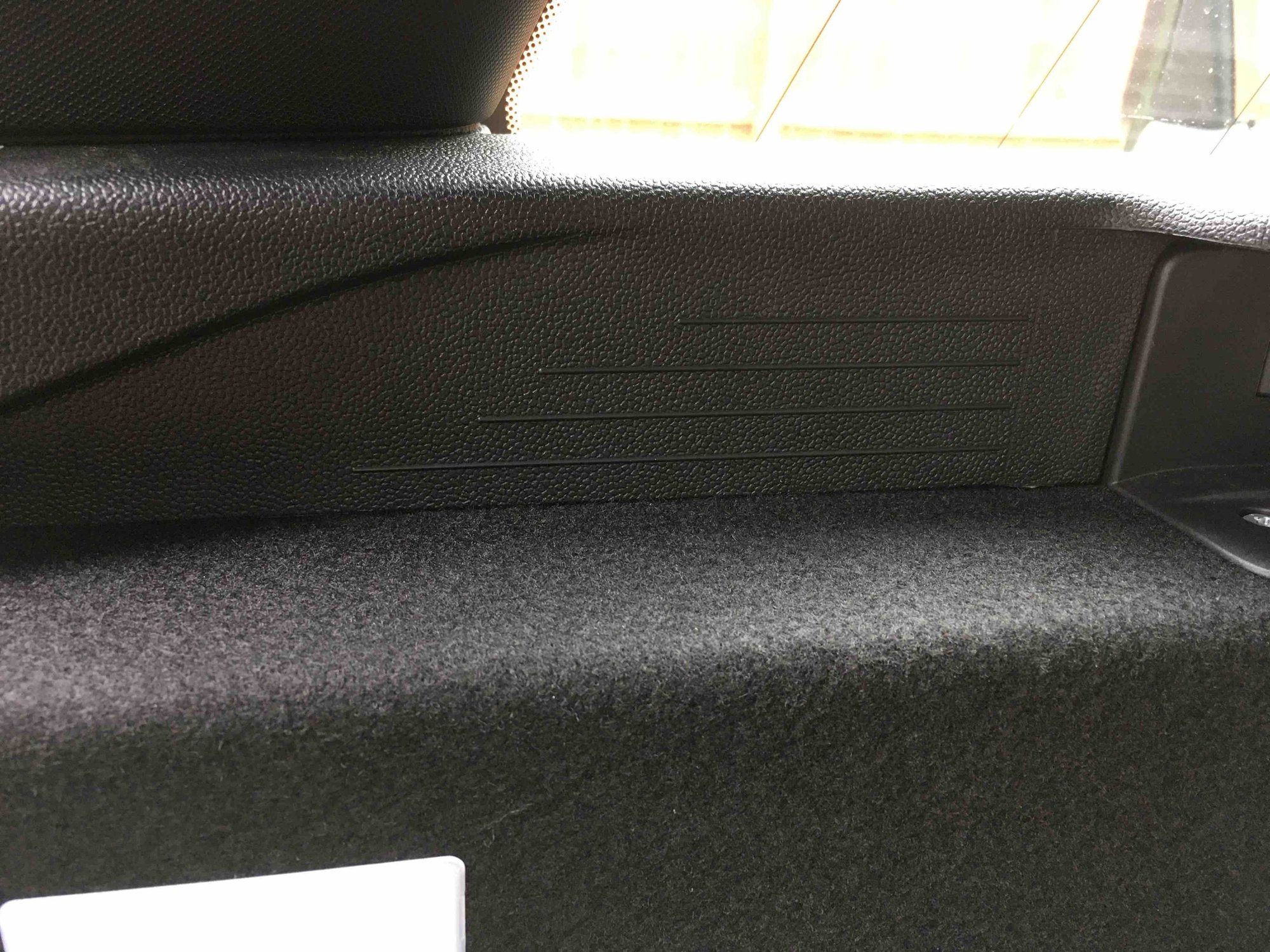

Well, I finally received my car (it was sitting at the dealer lot for a few weeks, waiting for a part for the factory roof rails to arrive [and yes, if you haggle, a dealer can install the factory rails on a clubman if it doesn't have them -- the install is actually identical to the F56, and uses the same drill guide!]).
I managed to put the trunk Center Trim piece in tonight, as well as the flat loading top, and the trunk liner/bottom which has a hole for the spare tire bolt to go through. In total it took about 20 minutes to install. I have never done vehicle interior panel work before, either, this was my first time getting to use plastic rivet remover tools.
My observations: the parts aren't really worth it. If I were going to do it again I would buy just the flat 'false top' trunk lid, and would just cut holes into the center mounting part. I would make some measurements of where the spare tire bolt is, and drill a small hole in the bottom liner. That would have made the upgrade about $188 for the cargo cover/false floor.
Anyway, you CAN retrofit the storage package, at least this much of it. I suspect Ferretdancer's dealer, or MINI, decided that the retrofit was too expensive to do for some reason. But at least on my vehicle, a Cooper S All4 (not a JCW), all of the hardware for the storage kit is built into the body. I will eventually get around to retrofitting the side panels with the storage pockets. I suspect that an issue with the trunk retrofit MIGHT be that the driver's side trunk light wiring either won't exist, or will need to be coded, for the storage package to work.
Oh, and another reason that they may have said 'no' to Ferretdancer's storage package would be the USB outlets for the rear seat passengers. I don't really care to have those, though.
Parts required:
51477360761 (false floor/hidden trunk cover): $189
51477427156 (cross member/center piece, not really needed if you don't mind measuring/cutting your stock cross member): $32
51477420086 (trunk floor for compact spare wheel, again not needed if you can use a measuring tape and a drill): $95
Remove three plastic rivets that hold in the center piece/cross member. Two are located just behind the rear seats (one on each side), with a third rivet in the middle of the trunk side.
Remove the bottom liner (it just lifts right out), and then remove the cross member trim panel. The cross member trim is tucked under the two side interior liners, firmly tugging it will pull it out. Also note that two cargo hooks pass through the center piece at the rear of the car, as well as a stamped steel bar for the rear seats passing through the liner at the front. There are grooves cut into the center piece for each metal part to pass through.
Install the new cross member. Fitting it back in is kind of hard because you have to tuck it back under the left and ride side trim pieces. I found that reaching my hand under/through the folded down rear seats allowed me to lift up the side trim and hook each side of the center piece underneath the side trim. Once it is seated well, re-install the three plastic rivets. Make sure that the interior part of the rivet seats into the metal on the vehicle body, and then push in the interior part of the rivet, which causes the outer part to mushroom out and hold. Give the cross member some push and tug to be sure the rivets are firmly seated. Then re-install the bottom liner.
The cargo top lid now fits through the holes into two bars, and can swing up and down. The only downside is that there is no stopper on either side of the trunk, but at least this makes a 'lay flat' trunk with hidden storage.
These are the two center pieces side-by-side. If I had known that this was all the difference, I'd have just removed the original, cut some holes in it, and re-installed it. I also purchased the 'spare tire' bottom liner, but again it wasn't really worth it. All it has a single hole in it which allows the spare tire bolt to mount up.

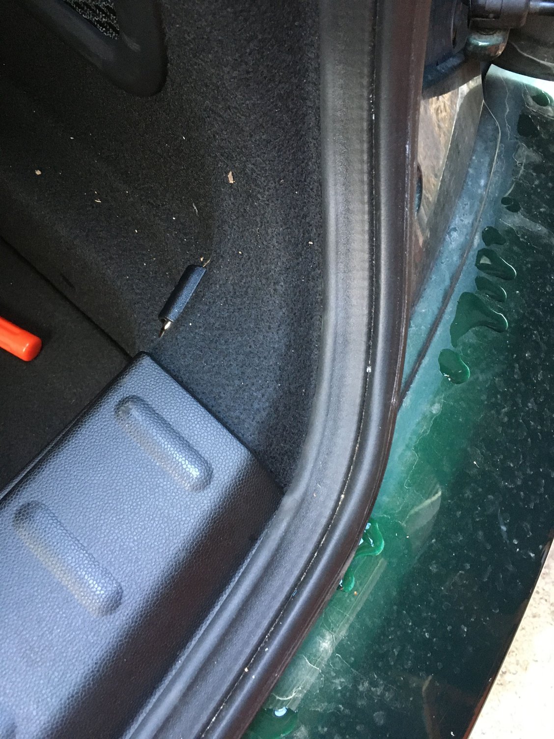

First, remove all of the stuff from your trunk. I installed the false floor cover earlier, and the spare tire, so all of that needs to go.
Then, pop out the four plastic rivets that hold the hard plastic trim at the rear of the boot, and remove the plastic trim.
Fold down your rear seats if you haven't already, and pop out the three plastic rivets which hold the side panels in.
Gently tug the side panels to remove them. I don't have the right panel yet, but I'm pulling the right panel out a bit to plug in (and test) my wiring harness. It worked fine! Forgive my dry, cracked hands, I've been washing them far too much lately :P.

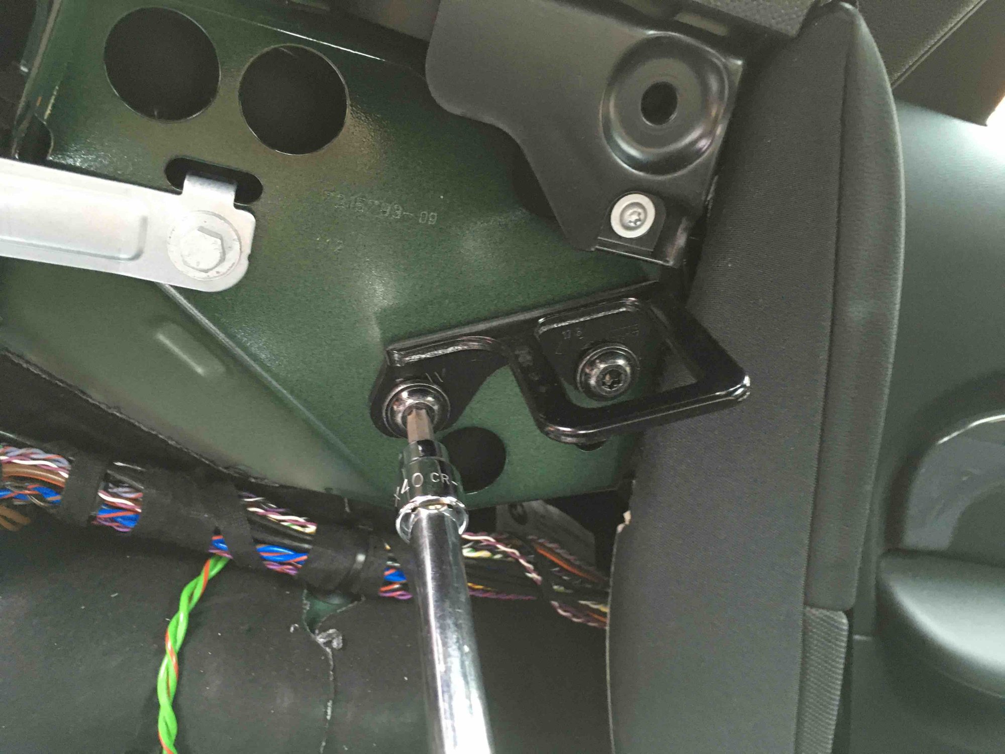

Now attach the tie-down ring adapter (41007401285 for the left side of the car). This requires two of the 07147147513 hex bolts, and one of the 07119905544 nuts to attach it). These all use 10mm hex sockets.
Now remove the original rear seat striker plate and bolt the new into place. This uses a TorX-40 driver.
Prior to tightening down the striker plate, it is a good idea to latch the seat into place. The adjustable striker has a little bit of play in it, so having the seat latched will ensure that it is aligned correctly.

Now you can install the tie down rings. Each of the tie down rings comes with the bolt required to hold it in, they are TorX 40 size heads.
Snap the little plastic covers onto the tie down rings.
I only installed one trim piece so far, but it holds up the false floor okay on its own. I ordered the second trim piece, but shipping delays have kept it out of my hands. I think with covid-19 going on, shipping things is going to be slow for a while.
In total, the job took about 40 minutes. This included figuring out how to get the trim around the adjustable striker, and realizing that you're supposed to bolt on the tie-down rings AFTER you install the trim (I bolted them on first, then realized I had to remove them as I was getting the trim around the striker).

After a long FedEx shipping delay, I finally got my storage compartment right side trunk liner.
Here's how it comes from the factory (part number 51477360774, ECS Tuning finally has an actual photo of the part, probably because I ordered it through them ;-)). Note that it comes with MOST of the pieces for the cigarette lighter (but not the metal housing that accepts the wiring, nor the lighter plug cover)
It also comes with the 'suit hanger' plastic clip thing, I ordered one of them thinking that the trim didn't come with it...
Here is the cigarette lighter plug insert, needed if you want power on the trunk liner. I haven't figured out how to wire this up yet, though...the plug insert shown above is part number 61346973037. The 'block off plug' (plastic insert for the cigarette lighter socket) is 61349316116.
Here is the wiring harness that I mentioned in the last post. The factory wiring for the lights is red+green stripe, and red, so I bought some wire with the same colors, as well as female and male plugs to let me connect both the wires to the stock plug. It works fine.
If anybody has a factory storage package and is feeling adventurous, I'd love to see where the factory cigarette lighter adapter connects to. I *think* the wires will be Brown (for the cigarette lighter ground) and Red+Blue for the +12V. I'm guessing that a wire runs directly to the fuse box in the front of the vehicle, but if somebody does pull back their trim, and sees it connected to one of the body controllers in the trunk, that would be handy to know!
My only other installation note: make sure your trim pieces all sit underneath the rubber gasket, when you're assembling the trunk parts all back together. That should, hopefully, keep you from having any leaking/water issues back here.
