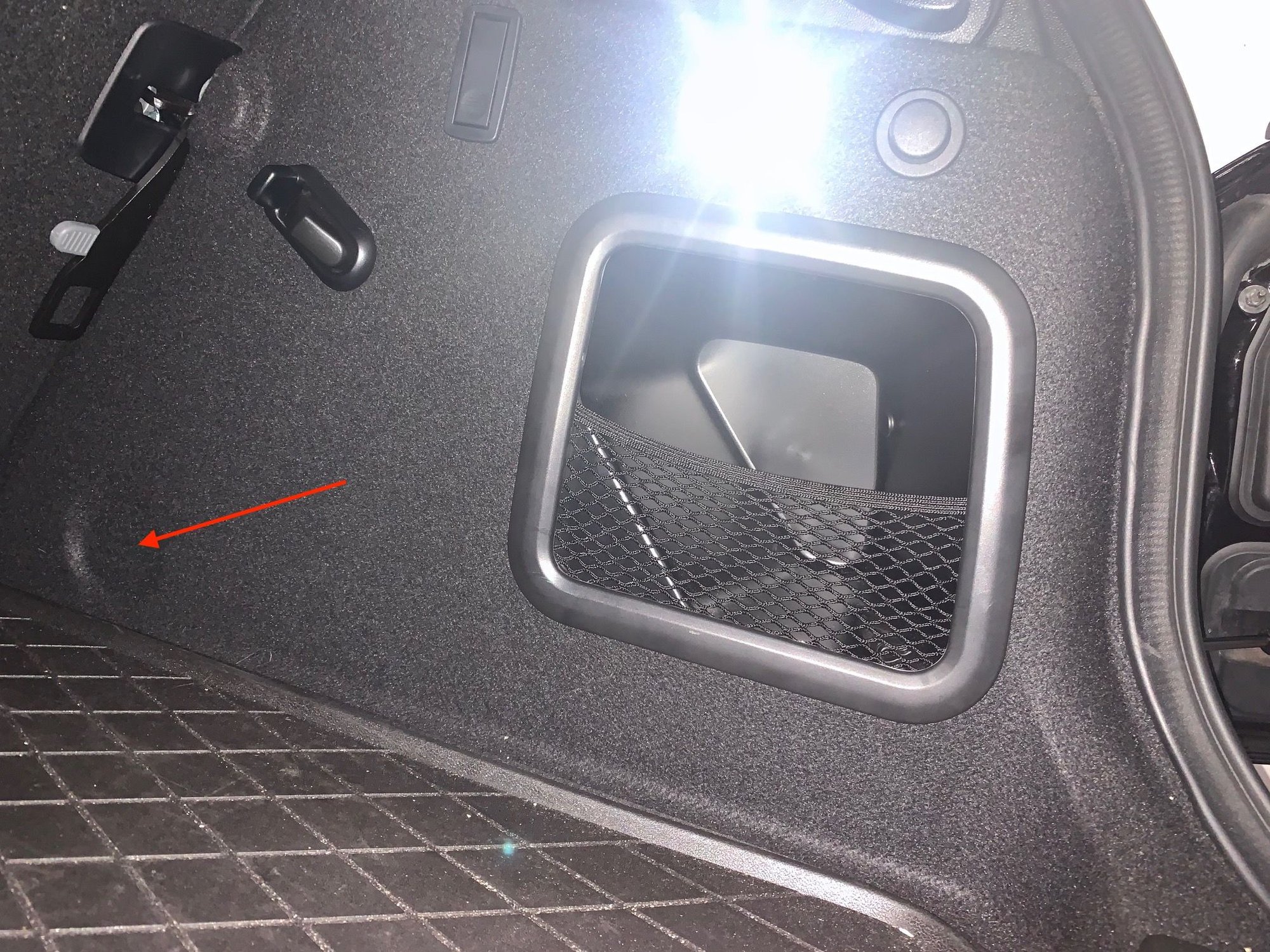

Just a follow up FYI, these are the trunk side trims that my F54 came from factory with...
As you can see, I have the Storage Option and all the relevant bits, but no D-Rings (nor elastic strap on opposite side)...
There's a circular indent at the side D-ring position....though smooth at the rear bumper position....
Apologies for poor pic quality, quick take in the dark garage..!

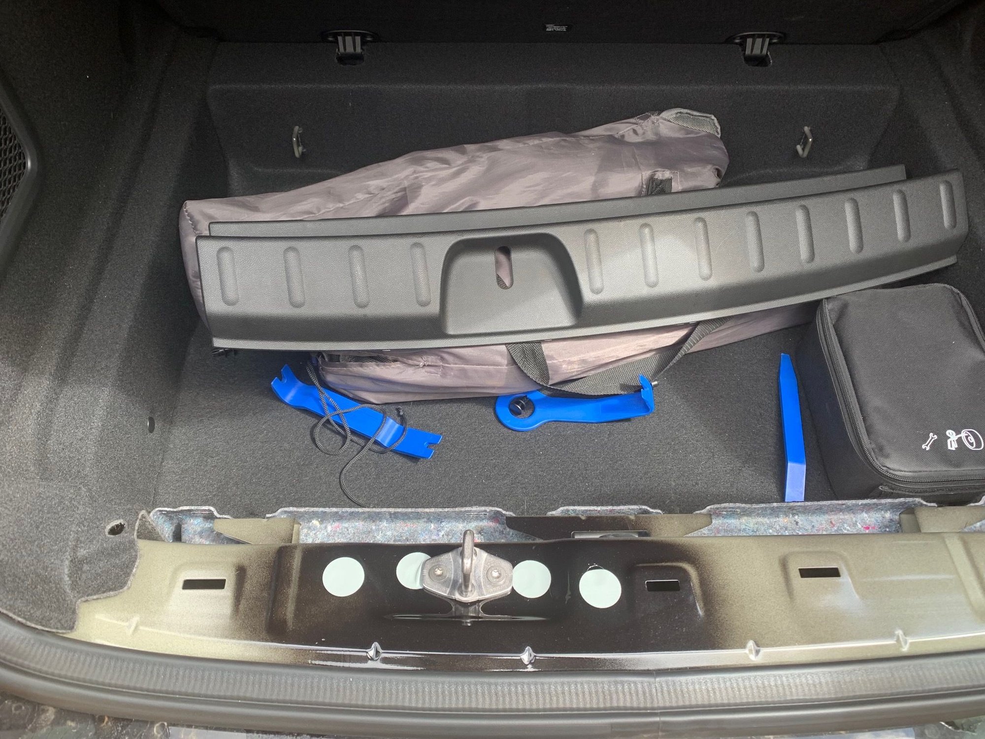

A bit of a delayed update –
So just a FYI for all JCW F54 (and I presume all other variants) owners that are '21/22 or later – the bodywork does still seem to have the fixing positions for the D-Rings, despite MINI seemingly no longer factory fitting the storage D-Rings and the supplied 'Storage Package' trim panels being 'delete' plain...
I eventually got round to removing the rear plastic trim and having a peek under the existing trim –
Fixing Bolt for Retainer Bracket
I currently have replacement side trims with the D-Ring cutouts (#51477360773 & #51477360774), as well as the rings and fixings etc, on their way to me from the UK – got a great price and even with shipping all worked out waaaaay cheaper than local MINI quote here (which was also ex-Germany 6+weeks)..! 🙄
Once the parts are here I'll do the swap over – I'm planning a Dashcam install (incl Rear) so the aim is to do everything at once...
Thanks again to everyone who has contributed info in this thread, especially @reidmefirst (I'll check out that 12v Outlet wiring, if you still need it?)
SC
