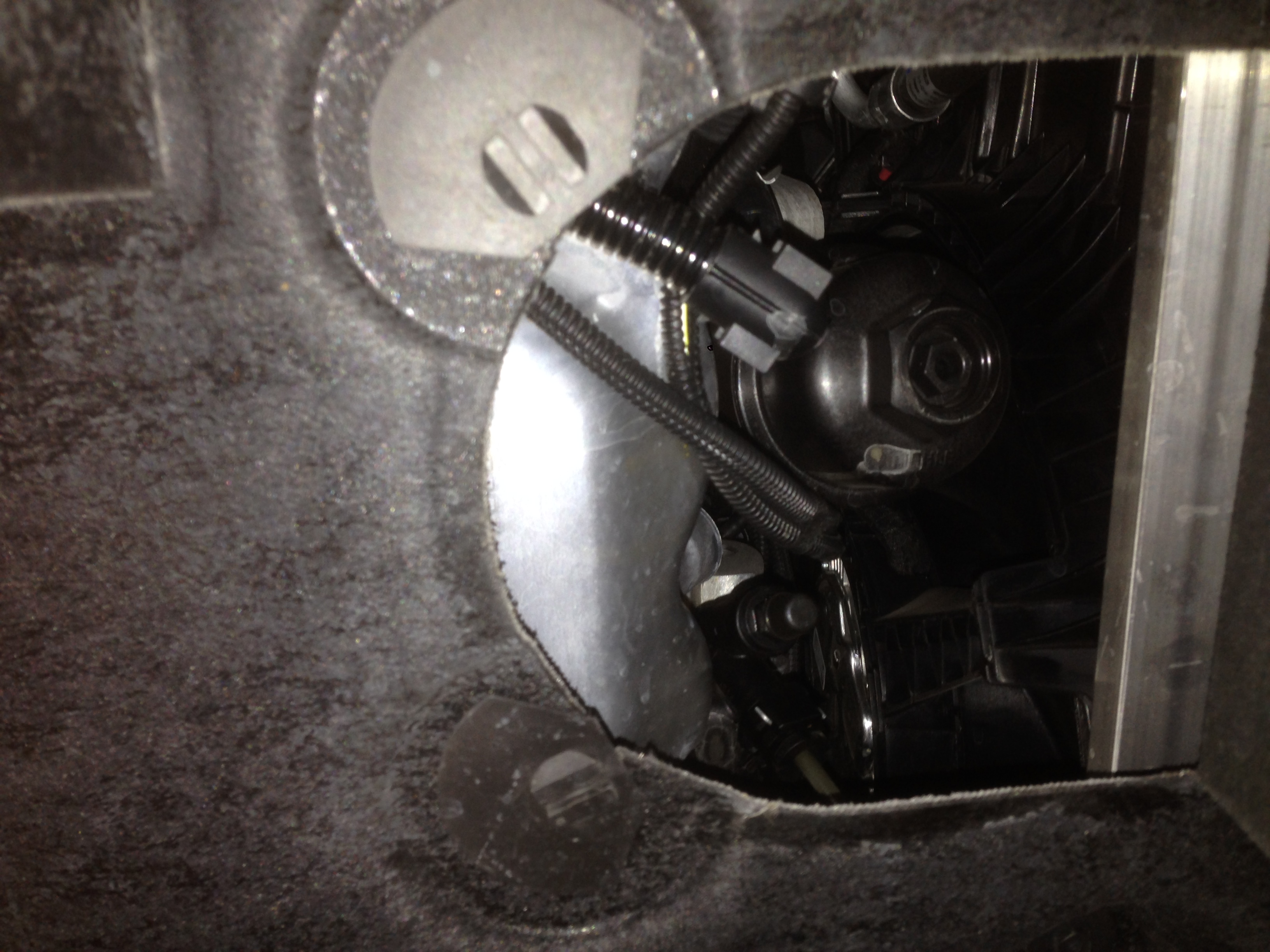

I have 9,000 miles on my 17 All4S and needed an oil change. Since the dealer is far away and I have a lift, I did it myself. There are two access flaps in the underside cover: one for the oil drain and one for the filter. BMW unofficially carries the parts. The current X1 has the same part number for the "oil change kit." The kit includes the filter, a new canister drain plug, the canister O-ring, and a new brass washer for the sump drain plug. The canister drain plug is an absolutely brilliant idea! My Porsche has a very similar system; however, they don't include a drain plug for the canister housing. Therefore, I have to very carefully try to remove the canister when it is full of hot oil. It's nearly impossible on the Porsche to do that without spilling some. However, with the Mini, it's nearly foolproof. What a fantastic idea. The only thing that I didn't like, was that the access flaps are not removable as they are with my current and prior BMWs. Instead, they just bend down. They tend to creep back into the path of the draining oil so you need to zip tie them out of the way to keep them clean.
Now if I could just figure out how to reset the service reminder I'd be all set...
Followup:
Holy moly! This (below link) reset technique actually worked (all from the odo reset button - the computer/stalk button isn't necessary)! I never thought this would work on a 2017 vehicle. After owning BMWs since 2003 and them not even listing the oil viscosity in the owner's manual (seriously - the manuals say to go to the dealer if you are low on oil), I figured Mini would follow suit and do everything possible to try to prevent owners from working on their own cars. For both the Porsche and BMW I had to buy aftermarket reset tools. I just can't believe that Mini would let owners do it themselves. What a happy surprise!
http://www.minif56.com/forum/754-how...intervals.html
Attached Thumbnails F54 Oil Change-img_2285.jpg   F54 Oil Change-img_2286.jpg   F54 Oil Change-img_2288.jpg

Hmmm. Doesn't look floor jack friendly.

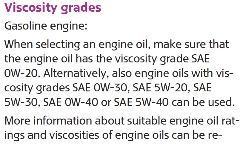

Did your MINI call for the new 0w-20 or 0w-30 in the owner manual? Some 2016+ models list it.

Thanks! 0W-20. This is from the owner's manual:

Yep, you found it. We just got some of the 0w-20 in 83212365955
