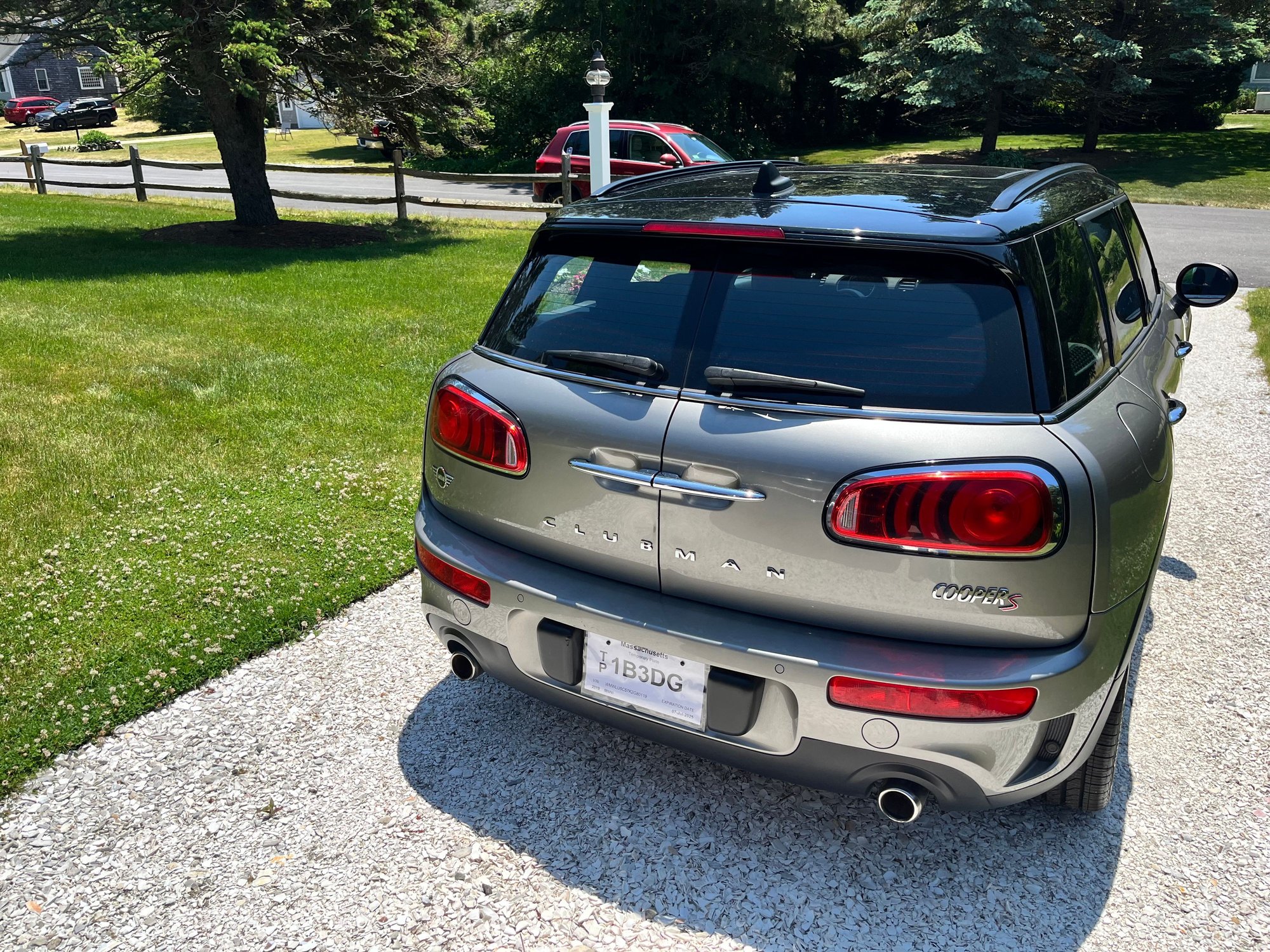

I don’t know when the black trim on the rear taillights was introduced, but my pre-LCI 2019 F54 S All4 has them.
