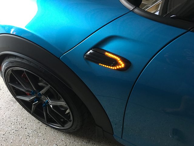

You are going to need some wiring adapters, I got them here on Amazon. I purchased the same LED side markers, tried the Bimmercode code route and that didn't work, just get the adapters. I even emailed OutMotoring and they said they would add it to the description as a "may be needed item".
iJDMTOY LED Adpaters iJDMTOY LED Adpaters
AND welcome to NAM!

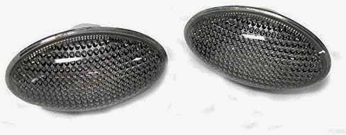

As this applies to an issue I'm having I hope no one minds if I jump in. I haven't been getting much response in "Hatch Talk". For my 2005 MCS
I'm doing the same thing [blacking out] and I bought rear taillights off Amazon. [build thread "Bargain $500 Mini"
These; [url]https://www.amazon.com/dp/B008TDB8BU/?coliid=I3UUF7VNN54URT&colid=1D5GRNJ0OXPDL&psc=1&r ef_=lv_ov_lig_dp_it
I bought them specifically as they have a ballast resistor already wired in. It came with double edge tape for mounting but as I know they can get hot I screwed the resistor to the inner fender liner.
So I'm getting Hyper-flash, despite the resistor. All the other turn signal bulbs are incandescent and all work.
1. I read where someone said you can't mix and match. I can't see how this could be true as you need a resistor for each LED bulb, and the resistor "fools" the computer into thinking the LED us using as much wattage as an incandescent. True/False?
2. Low battery voltage can cause hyper flash. I trickle charged my 4 moth old batter to float mode and no change. So low voltage True/false?
3. I even tried adding a second ballast resistor inline with the first. No change.

@robj is it an R53 you have? Those lights look like R53 lights, if so BimmerCode won’t work with that model mini. I also have an R53 in the stable.
Old Mar 12, 2020 | 10:06 AM
robj's Avatar
robj
Joined: Oct 2019
Posts: 587
Likes: 294
From: Maryland
Yes, it is an R53.
Thanks for the heads up.
Actually the hyper-flashing may have cured itself. I think it may have been low battery voltage as at the time I had the intake apart to replace the master-cylinder and couldn't start the car. I had a battery tender on it for a few days and when it went into "float mode" seemed to work better and now that I can start the car, it seems good.

I have the same hyper flashing issue with the exact same led side marker lights and it is always when I first start my vehicle I have to turn on both my turn signals 2-3 times to 'clear' the hyper flashing then they seem to work fine but I just ordered to canbus adapters from the above link at amazon and should receive them sometime in the next week and will update on how they work as soon as I install them...
UPDATE: I installed the canbus adapters that I ordered off of Amazon earlier this week and no more turn signal hyper flashing from my LED side indicators. PROBLEM SOLVED!
