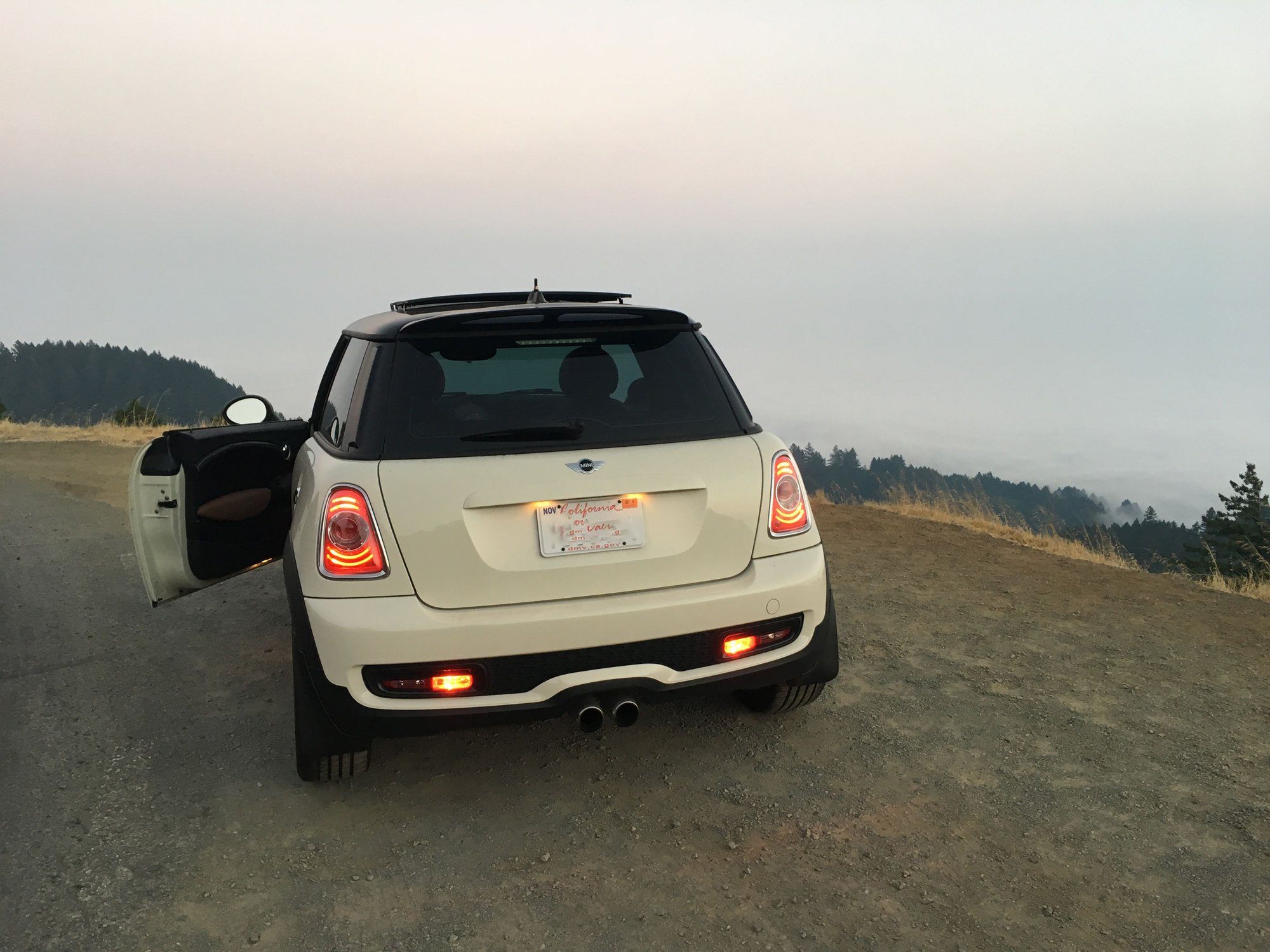

The mechanic is wrong! In fact, getting them to work as brake lights requires rewiring and not just reprogramming.
I also have a 2013 Cooper S and I got mine working just fine!
Spoiler
All you need to do is buy a replacement switch and put it into place. Then reprogram the car with NCS Expert and an OBD-II cable. There's a lot of great posts here detailing the whole process - which is how I found out and got mine working.
I can send you links with more info/files if you want.
Old Oct 19, 2018 | 04:29 PM
Nui's Avatar
Nui
Joined: Apr 2007
Posts: 424
That would be amazing! Do I buy the switch at the dealer? Most importantly, is the wiring there ready to be hooked up? I imagined it would take a long run to the lights. Please send the links. Really, really appreciate it.
Old Oct 19, 2018 | 05:47 PM
anew742's Avatar
anew742
Joined: Feb 2018
Posts: 37
From: California
The wiring and even the bulbs were already in place!
I got the toggle switch from Way Motor Works: https://www.waymotorworks.com/used-r...7-r58-r59.html
(link is for a used one, they also sell new. I bought used since it's half price and not noticeably different)
I reference this post for information: https://www.northamericanmotoring.co...beginners.html
And this one: https://www.northamericanmotoring.co...s-you-can.html
I got a cheap cable like this one: https://www.ebay.com/itm/BMW-INPA-K-...pid=1263694158 which works just fine
The reprogramming part didn't take very long, it just involved changing code from "nicht_aktiv" to "aktiv" lol
To get the toggle panel out, I just wedged a flathead screwdriver under each corner and shimmied my way across...not exactly elegant, but it worked
Sorry for the info dump! I don't have the time right now to explain properly, but I figured that this would be way better than nothing!
