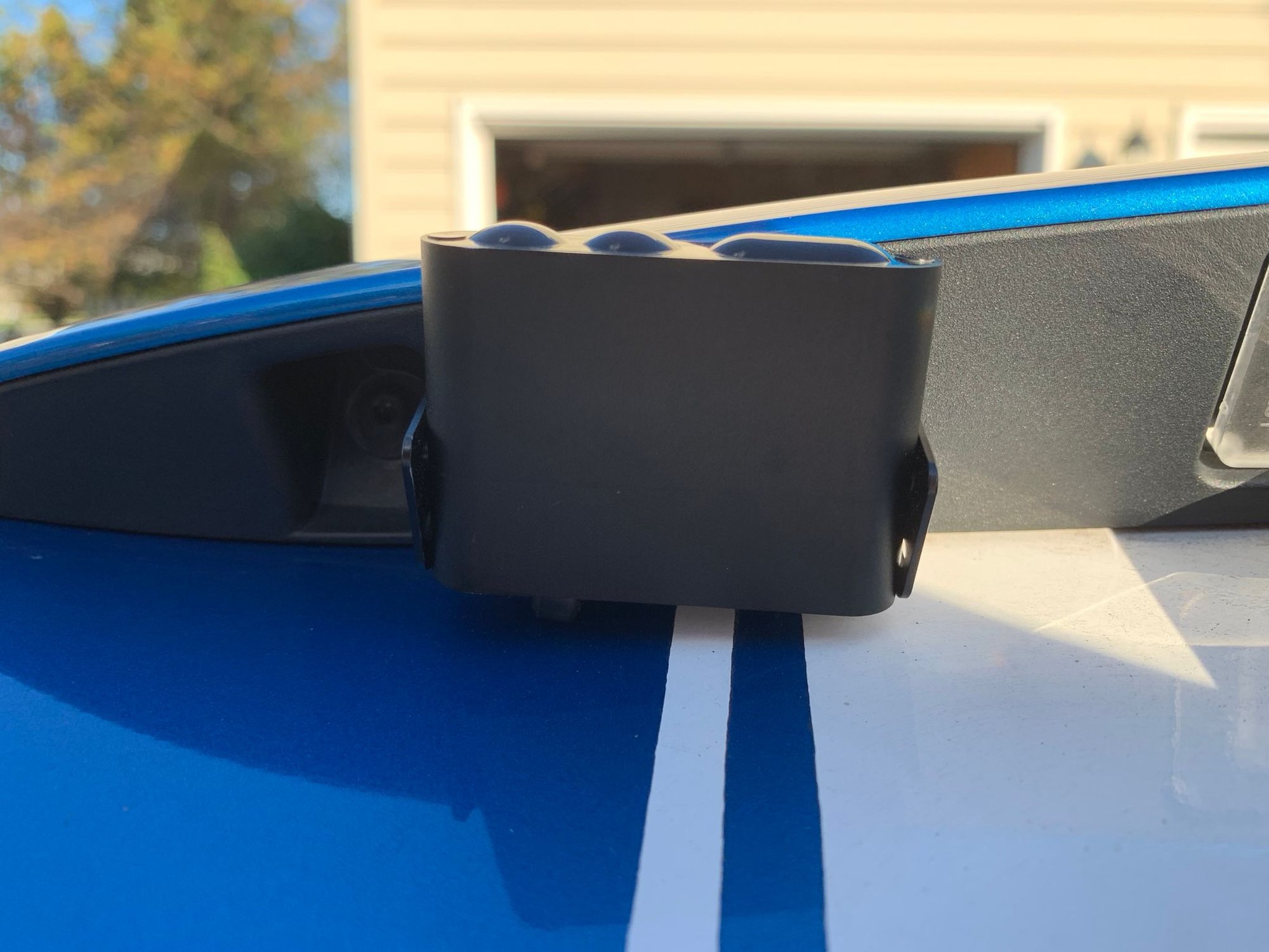

After I routed the wiring through the firewall, I moved on to the rear head installation. Unfortunately, this step required quite a bit of modification to the existing boot handle and also required I enlarge the hole in the boot to get the wiring into the car. I used a grinding wheel to enlarge the hole, wincing at every millimeter of steel removed. The things we do for love (of speed).
Boot handle modified.
Left rear head mounted.
Right rear head mounted.

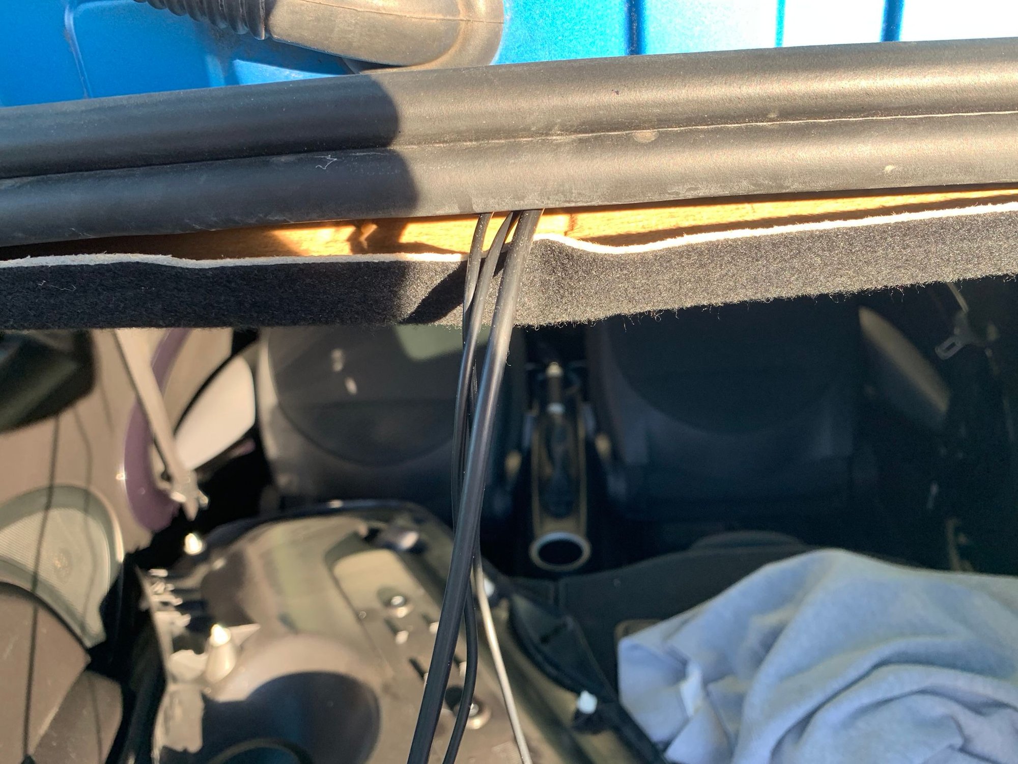

One of the hardest parts was just getting the damned wires through the boot grommet. I was also feeding through two additional wires for a backup camera I installed during this process and it was TIGHT! After the wires were snaked through the grommet, running them to the front by tucking them under trim panels was straightforward.
Wiring through the boot.
Routing TMG wiring with factory harness.
F’ing boot grommet...
Finally!

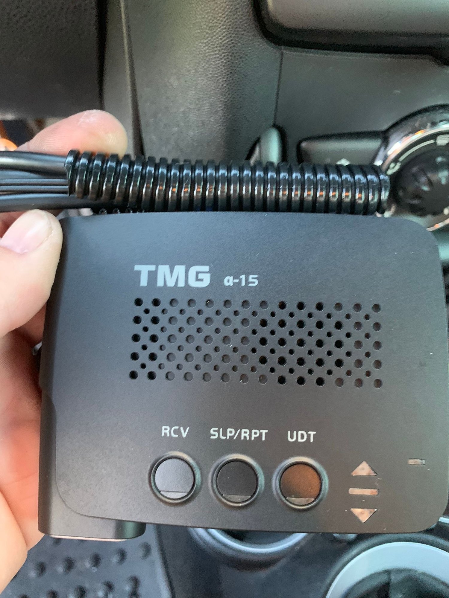

I finally connected everything up and mounted the CPU in the lower console tray. It fits like it was made for it. Very cool.
Compact a-15 CPU.
CPU installed in console tray.
