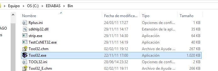

To reset the ELV you have to use the "EDIABAS ToolSet 32", connected to the car via OBDII with the same cable of INPA and NCS Expert.
Connect the cable to the OBDII Port, insert the key and press start button (don't start the car, only ignition ON). Open the software EDIABAS ToolSet 32.
HOW TO: Reset ELV counter. Steering lock RED warning-0dxawoa.jpg
On the menu, select File -> "Load SGBD, Group File F3"

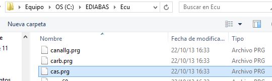

Look for "Cas.prg" on the file list.
HOW TO: Reset ELV counter. Steering lock RED warning-ca1kmle.jpg

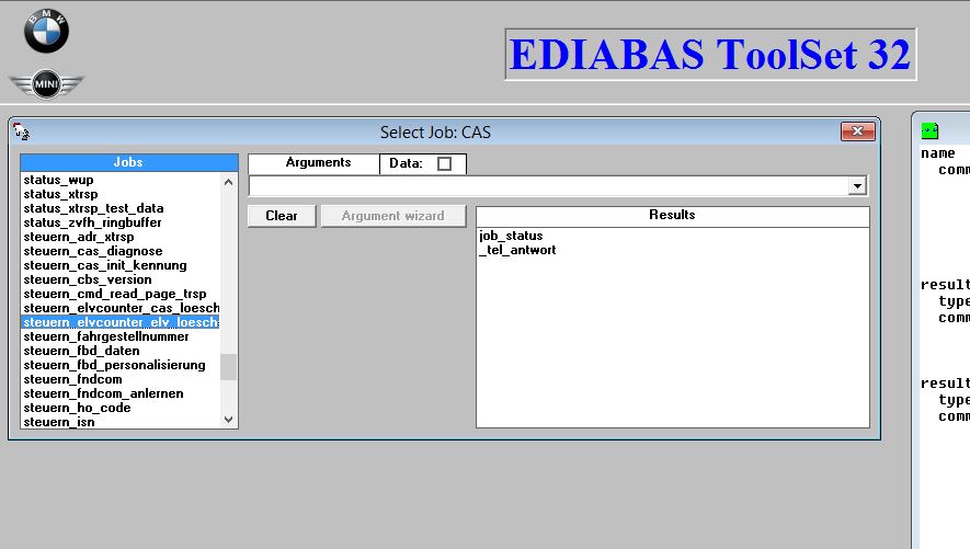

Look on the Job list the name: "steuern_elvcounter_cas_loeschen" and "steuern_elvcounter_elv_loeschen". Double click on each one, and wait for a window, it says "Job Done" on the bottom.
HOW TO: Reset ELV counter. Steering lock RED warning-j2haw02.jpg
DONE!, no more RED Light Steering lock issue.

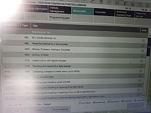

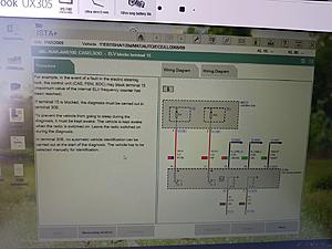

ELV Yellow warning, Car does not start :S
Hi,
could someone help me, please? My car does not start (E87). I have got a yellow elv fault. I tried to reset it with ispa, but it does not work. Please check the pictures.
Does anyone have any idea what is the problem?
