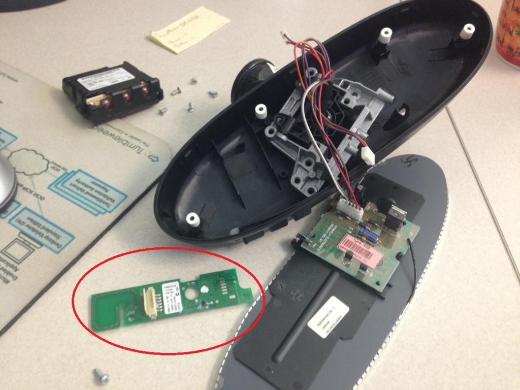

I had water get in my rearview mirror, causing the remote receiver to stop working. After letting it dry for a few days and still not working, I decided to open the mirror and try to work a miracle. I took the little board out of the mirror, sprayed with canned air, and cleaned the contacts with a pencil eraser. I put the mirror back together, installed it in the mini and reprogrammed the keys...IT WORKED!! I was happier than a dog with two tails...I strongly believe I was lucky, so I cannot guarantee it would work for everybody. But nothing wrong with trying when it is already messed up, before spending over $200 on a mirror.
If I can figure out how to include picture, I will.
Old Jun 27, 2014 | 08:15 AM

Old Jun 27, 2014 | 08:28 AM
joylove's Avatar
joylove
Joined: Sep 2012
Posts: 699
Originally Posted by jkayak
I guess I don't know how to post pictures...
