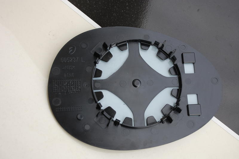

wkearney99 - The stock glass is heated. See above
No, it's not.
I just pulled the driver side mirror glass off our R57S convertible. I've attached a picture of the back of it.
No sign of electrical tabs, nor the stripes across the back of the glass. Just plain old glass on plastic. Now, the plastic shows where the tabs would go, but they're not there on this stock mirror.
Attached Thumbnails retrofit heated/dimming side mirrors?-dsc_1507.jpg

wkearney99 - They must have just made one glass type for replacement if you have heated or non heated = you get the heated version . It just does not function. Must have been very plain like that for production only.
