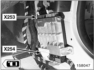

The parking lights and license plate light are connected directly to the BC1 computer (not so convenient to deal with). If you are willing, the wiring diagram says the parking lights are pins 7 (black/blue wire), 11 (black/green), 29 (grey/violet), and 42 (grey/yellow) on the 54-pin connector X254. It's an off-white connector on the bottom of the BC1, behind the side panel in the passenger footwell.

@rkw, thanks for the info. Any pics/diagrams by any chance? What relay would I want to use? Seems like that would be simpler than running a wire all the way to the passenger footwell.

Looks like rkw took care of the wire locations. Relay might be a good option too like he recommended. Although I wonder if the gauge flickers from the dimmer, would a relay do the same?

Attachment 49890
That was my thought as well. I don't see how a relay would react differently but I'm not an electrical expert. I think I'll just try tapping into one of the wires at the BC1.

If you tap into the BC1, it might be a tiny bit easier to access the license plate light because it's in the X253 connector on top (pin 4, grey/yellow wire).
