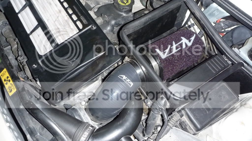

Originally Posted by Tanuki
I installed my CAI today and for somereason that silicone tube just doesnt seem to want to fit with a lot of adjustment. I am still not sure that it is completely set up correctly.
Thanks for the business and the post. We want to be sure the part you have is 100% Perfect! Can you send me: Adam.Taft@ALTAPerformance.com some photos of it installed and or off the car?
We will get it figured out ASAP!

Adam,
Not a problem. I am going to remove it tonight and put it back on. I will take photos both before and after the reinstall.
Here is the most detailed shot I have as of right now:

Tanuki,
From that angle, it's hard to tell if it's rubbing or not. Is it touching the supercharger? Or is there another problem?

^Great news. I pulled it all off again tonight and reinstalled it. My big issue is that the bottom of the hose slants over the throttle body rather than being flush. I left it at that angle and fit the clamp to that angle and just tightened down. I believe I have space between the hose and the supercharger now as well. Now reinstalled, the bottom seems tighter and everything seems to be just fine. I am still a fan of the CAI from ALTA.
Is this too close to the SC? I can fit a sheet of paper folded in thirds between the tube and SC.

I had problems installing mine as well...were the hose sits on the throttle body, it was at a slant and not flush. When it was all together I pushed in and down on the hose towards the throttle body and tightened it. Hell...but it worked.

^That sounds the same as mine. Maybe if that side was just a little longer? The problem is that when you go to put the fresh air pipe back in, and it says to "Fold back the hose" it is close to impossible without pulling the bottom back off the throttle body.
