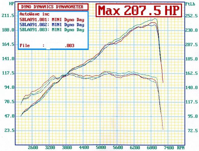

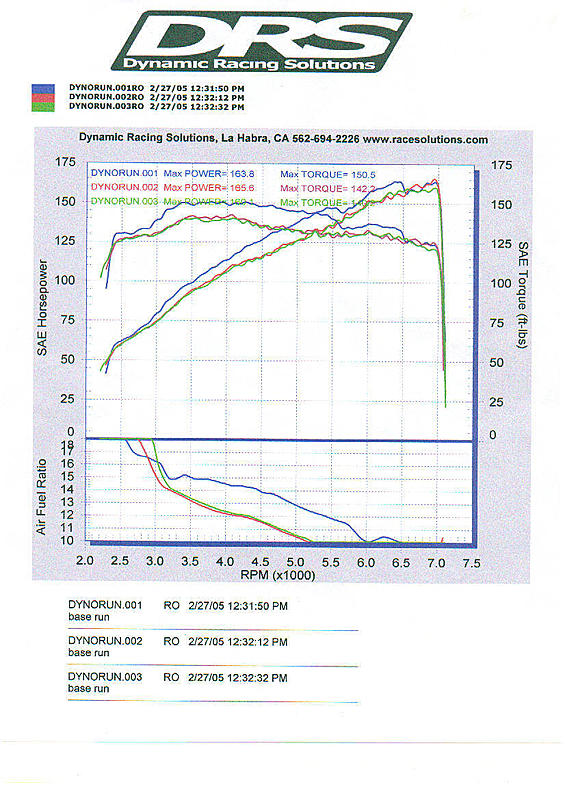

Dyno charts:
Here are dyno charts.
before head, OBX header, alta bigger intake hose (just remembered)
2/27/05: 165.6 hp, 150.5 ft. lb. tq.
I believe temp. higher than 80 deg. F., arrived hot and nothing done to cool intercooler except blow air over intercooler.
graph 1 below
8/12/07, after head 207.5 hp, 166 ft-lb. tq. Temp. about 80 deg. F., maybe less
intercooler cooled with some ice before the last run.
different dynos, 91 octane gas

42 hp delta... Not bad! My car was always strong, I dynoed around 191 on a dyno dynamics before the head.
