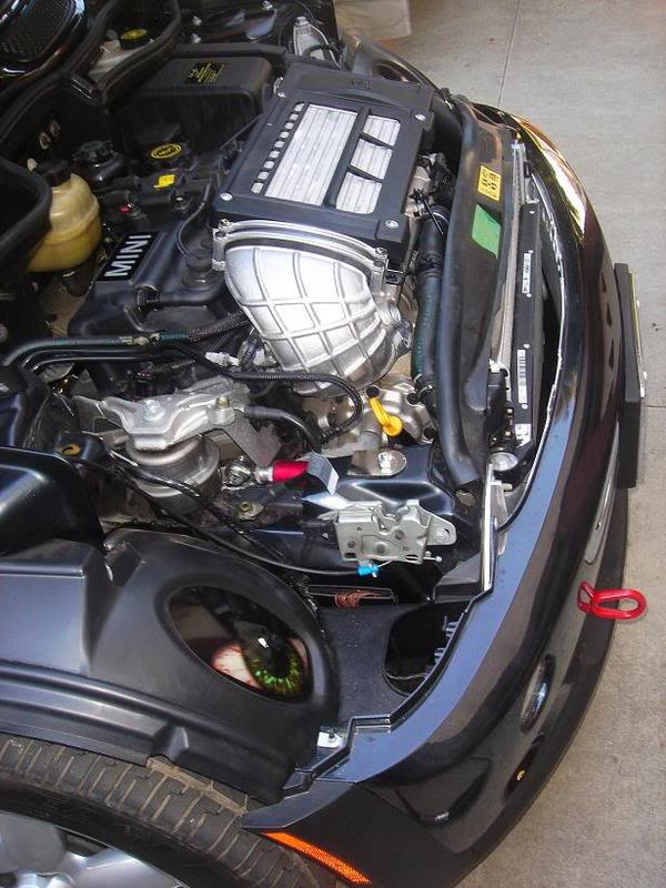

I got my engine damper today along with my spygear toggle switch! I just got done installing it. masking tape is needed to keep the pieces together. finding them after you drop them is a pain. I have an MCSa and you need to grind down the frame a bit to get the bolt to go where you want it to, I couldnt find any other way around this, I looked into my dads MC and he had so much more room to install an engine damper. well after grinding the frame a little, the rest was a breeze. I took it for a test drive and it felt great, no more bucking especially when I gently apply pressure on the brake to slow down. This is a great mod, and for only $55, plus shipping, its cheap too!Name:  damper.jpg
