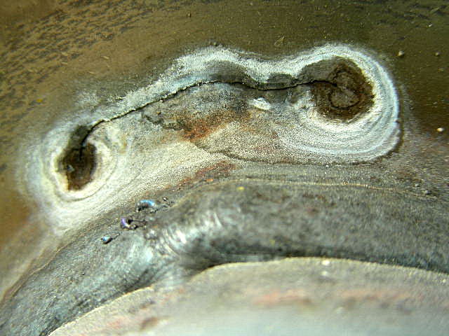

Old Jan 15, 2006 | 07:02 PM
k-huevo's Avatar
k-huevo
Joined: Aug 2004
Posts: 1,629
From: Pipe Creek, Texas
This a picture of my Milltek resonator with cracks at 25,000 miles. There is another crack directly above the pipe but I can't get the picture to attach. After 3 bad headers and two troublesome catbacks I don’t have a favorable opinion of Milltek products.

Hmm, that's a bit nasty.

The other crack.
Interesting.... did they make good on the lifetime warranty?

Once, shame on you, twice shame on me; a sixth? I don’t think so; no more Millteks for me mikem53.

It's not a Milltek, but I had an RSpeed resonator come apart inside, so there were no outward signs.....but your words are a perfect description of the sound I had. I got under the car and started bumping things w/ a rubber mallet and rapping the resonator told the tale. I had a local shop cut it out and weld in a straight pipe, and then it was easy to see the perforated inner pipe had cracked and broken and was rattling around inside.
