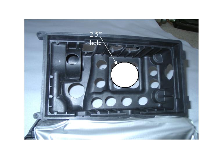

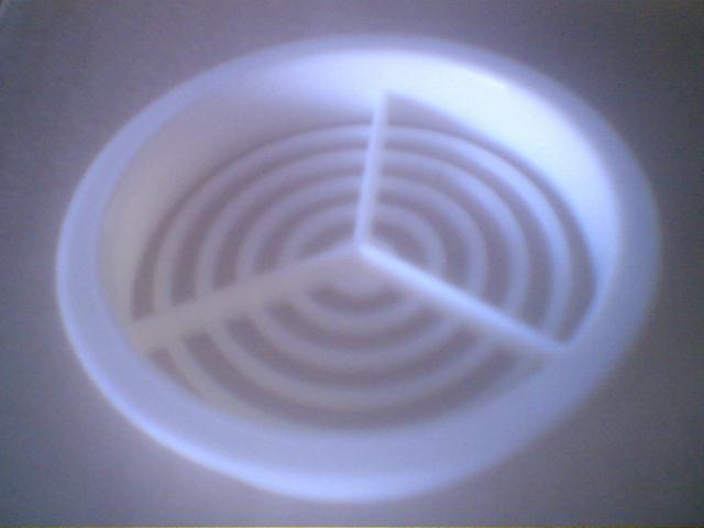

I did mine last weekend. Rather than going the swiss cheese route, I put in a single 2.5 inch hole in the base. I dressed the hole buy puting in a press fit circular vent fitting that had a small bell mouth and a grill. My reasoning was that the current intake pipe is approx 2.5" dia, so putting in an other 2.5" hole will essentially double the airflow. Since I doubt the stock airbox chokes the air flow by 50%, doubling the available airflow should be more than enough. Also the airbox retains its stock look.
The difference in the car's performance was quite noticable. This may be because I am running a 19% supercharger pulley and the standard air box was not up to the duty.

Sorry Joker, I didn't take any photos of the installation. But here is a picture of vent fitting and I have marked up Flyboy2160's picture where I installed the vent.
Aldo

Originally Posted by Aldo
....But here is a picture of vent fitting and I have marked up Flyboy2160's picture where I installed the vent...
aldo,
my picture is of the bottom of the box. did you put that vent in the bottom or on the top as mac was suggesting? [edit. actually the sides of the top make the most sense for the UNI plugs.]

Flyboy, yes the vent is at the bottom of the air box (ie the dirty side) The vent it's self does no filtering. The Uni plugs have a filter element, so you could put them though the top air box (ie the clean side) but I would seriously consider the filtering efficiency of these over the long term.
