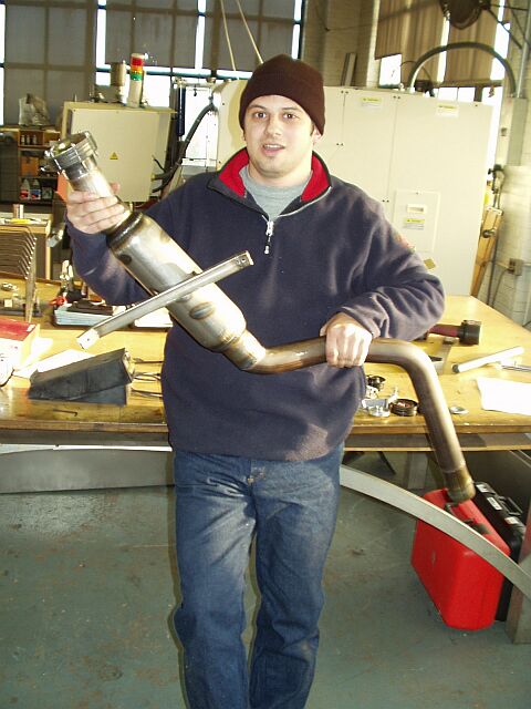

That ain't got nothing on this SCCA-championship-winning design:

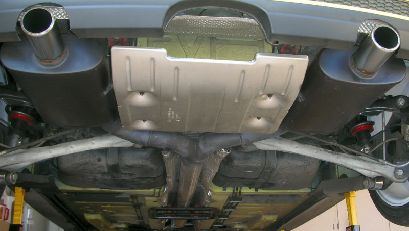

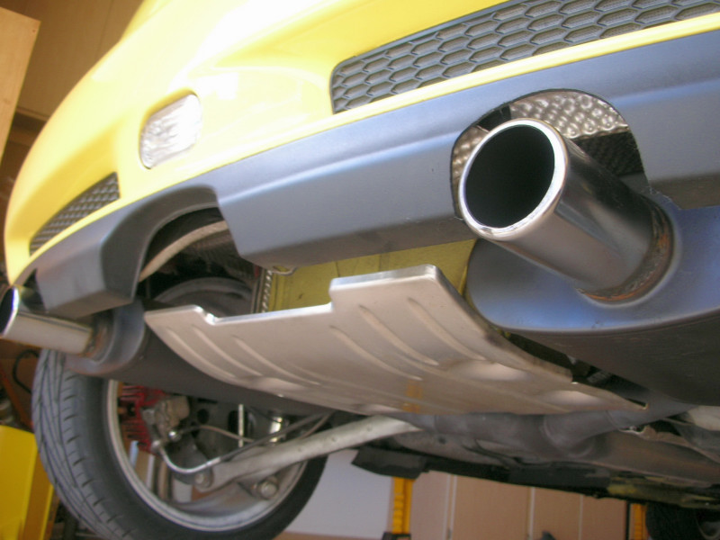

Custom 3" magnaflow from Meineke Mufflers
3" magnaflow resonator
splits into 2x 2.5" pipes each with a 14" magnaflow muffler
non-showy tips
Gained me about 10hp on the dyno if memory serves.

i like that a lot.... minus that hole in the center!
