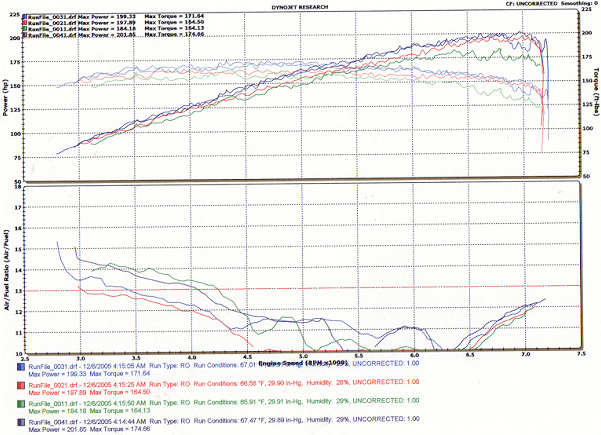

200whp dyno
here you go..
stage1... 2005 cooper S.. mth software/header combo, alta intake"stock tube", miltek exhaust, 2%crank pulley, 15%reduction pulley, kingsborn wires, ik22 plugs, and motivation... (btw, 91 octane for fuel)
200whp total doable..

I'm impressed with the torque number but not the A/F graph........great power congrats....I am concerned with the A/F graph though.......can you explain why it is so irratic (sp?)

very very strong car! Hope you don't get flamed into an oblivan... seriously good work! A/F is a little funny... but you did just eek past the number!

it has been tough getting my car leaned out.. if you look at my earlier dynos they are all extremley rich.. been trying to get mth dial out the richness for extra power.. that particular dyno is there lastest wack at leaning out my a/f mixtures.. in a perfect a/f mix, i wouldnt gain anymore peak power.. however, the mid range could look fatter if were dialed in more..
i'm satisfied.. 200whp for less than $3000.. cant beat that..
my local stealer wanted $6800 for the JCW works kit.. thats only 180hp at the wheels..

i know some people on here will just say it was the dyno.. well, i friend of mine with a 300c srt8 was dynoed the sameday.. its supose to have 425hp at the crank.. it only got 368hp on his graph for a baseline.... thats roughly %15 drive train loss...
who knows...
i'm happy with choosing my list of mods...

BM: that leaning out trend of all the A/F curves above 6k is what led me to larger injectors, suitably tuned back lean at lower rpm's. 12.5 is a good number to shoot for

jlm, is 12.5 safe with the level of advance that we typically see around 6k? I guess I would presume so since 14.7 [right?] is Stoichiometric, but I don't know, so I'm asking you.... Do you happen to know what spark advance you're using up there [w/ 12.5 A/F, if that makes any sense to you...:impatient]? Thanks!
