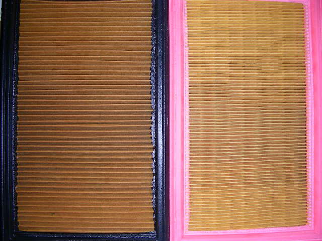

I often see intake comparisons where the stock air box is used as a baseline and it makes me wonder whether the stock filter is well used. I recently asked one of the participants in a high profile comparison if the stock filter was the one the car for its 2000 mile life and it was. When I change my filter at around the 5000 mile mark it's relatively clean but when I changed the filter on a city dwellers car with the same mileage it was almost black. A filter like his could be quite restrictive. One of the questions that come to mind is what we have seen in the way of gain difference between stock and aftermarket intakes an absolute based on equal starting points?
I saw some numbers for air mass flow on a head modified MCS motor running on a dyno without an air filter. I compared them to my head modified motor with the stock air box & clean filter and they matched. How can my car, on a very hot day, with major heat soak & astronomical IAT’s, flow that much air with a supposedly inept intake?
I know that flow is not an end all for acquiring power. Using my naïve logic; my point would be if the stock intake is as bad as it’s supposed to be, the incoming air for my car should have been choked off resulting in much lower mass numbers.
Although the part number is the same the stock air filter has changed. It’s now made in the Czech Republic rather than the U.K. The pleats are more numerous 73 as opposed to 52 for the old; however, the available top filter area is 10mm narrower. The new filter is very flexible instead of stiff like the old and the paper is lighter oiled than the former style and as you can see the foam edge is pink. BTW, the standard cooper has been this type for a while.

I’ve seen the data showing minuscule pressure loss across the older model stock filter and I’m aware of the many variables affecting gas mileage; let’s agree from the start this is not empirically validated evidence. But, some good news about the stock air filter part change; mileage has increased on my vehicle by 1.5 mpg compared to the previous stock filter. Neither the BMC cotton panel filter (which is see-through) nor the Alta CAI caged foam filter had this impact.

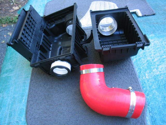

To answer your comments.
The stock air box will only accept a flat pannel filter. Most of the aftermarket cold air intakes have a high-flow cone filter. The cone has more surface area than the panel filter and will allow the engine to breathe easier.
Since I'm cheap and like to work on the car myself, I decided to try and make my own cold air intake. Much testing has been made here on NAM recently with guys trying to get more cold air into the engine. Things like insulating the aftermarket cold air intakes and putting lids on them. All in an effort to shield it from engine heat. The stock air box is made of plastic and has good insulating properties. This is great for cheap me.
Most of the aftermarket intakes have you make holes in the cowl partition between the intake and the cowl area by the windshield to get fresh air. The stock air box has a small hole to this cowl are in the lower portion of the air box. One of the photos you saw was where I used a 2.5 inch hole saw to make this hole bigger. I also used foam to seal the connection from the stock box to the cowl. Anyone can do this without having to replace the stock air filter or someone who wants to use a k&n drop in filter.
In order for me to use a cone filter in the upper portion of the stock air box I needed something in there for it to mount on. I got a 3 inch 45 degree pipe elbow and hacked the ends off and made it such that when attached to the box it made the filter sit at a slight angle. This was so that I could get the largest filter possible in there. Well, as large as I could find and be satisfied with. I was pretty picky about the filter and spent way too much time researching them. I also chose the 3 inch pipe so that the opening would be larger than the stock opening. If you look carefully the stock intake pipe is offset in the lid. This made it hard to find a filter to fit and I wanted to make sure that the pipe I put in there didn't restrict the intake pipe.
I hope this all makes some sense and answers your questions.
Very cool mod.
Thanks, norm
