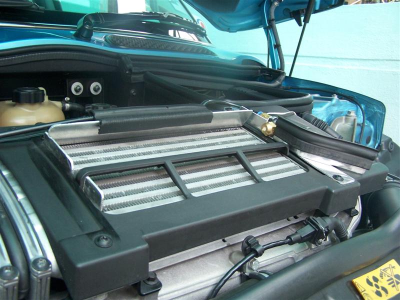

Some dry ice might help but I dont know how many blocks you need for the whole track session... Many i guess!
Water sprayer... hmmm, good idea! Like this?
Attached Thumbnails Dry Ice/Intercoolers-picture-085-medium-.jpg

If a larger IC is out of your budget, why not try the Alta diverter. It comes with a water sprayer. I would think trying to divise something to hold the dry ice above the intercooler and still not impede the air flow would be difficult.
