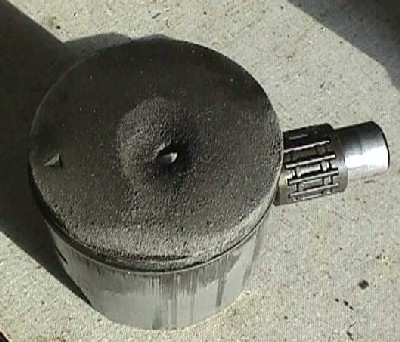

It's not possible for the engine to not ping at a certain heat range, then start pinging (pre-ignition) on a colder range. Perhaps what you really observed was misfire due to fouling.
Also, when you do have too hot of a plug, it's not the plugs that melt - it's the piston. Attatched is what happens to the piston after the plug electrode begins to glow red hot and melp the aluminum piston.
If no one has done so yet, I will have to - the only way to check is to read the plugs.
