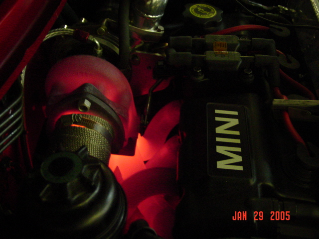

Old Feb 7, 2005 | 10:16 PM
El Diablito Rojo-N20Mini's Avatar
Joined: Aug 2004
Posts: 864
From: So Cal
wanna see heat-soak?
Old Feb 22, 2005 | 04:51 PM

somebody edited out this....
