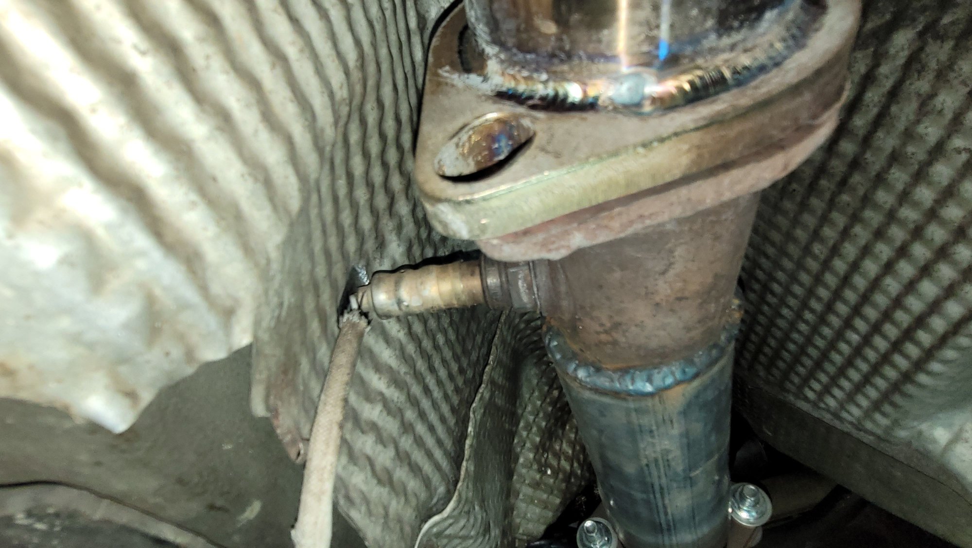

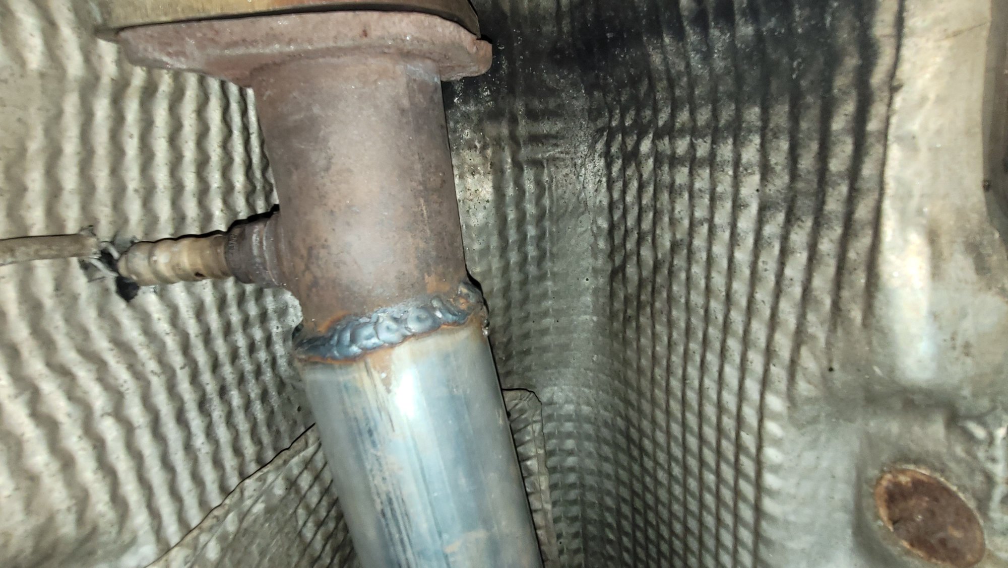

Well, you know I was completely wrong and had TOO much faith in the muffler shop doing quality work...
The shop didn't even attach the exhaust together!
Their work was absolutely horrendous, yes. That is the o2 sensor pushing into the heat shield.
The midpipes prongs that attach in the gasket have worn a hole through the heat shield!
I didn't know this until last night as I've been driving my Infiniti all week (have been driving long distances for work, and putting in 60+ hours)
Anywhoo, the shop welded the straight pipe at an angle, so nothing lines up. This morning I took the MINI to a more professional auto shop, they do all of our fleet vehicles, and everyone in the shop they wouldn't be able to do anything with exhaust now. Not weld in a new cat, the OE car, or even center up the straight...
·• The mechanics all said it's a Federal offense for a commercial shop to straight pipe or do anything that effects the catalytic converter's filtering ability!?
·• Another opinion was that the headers NEED the flex joint, without it the headers absorb the engines torque and flex... Making them liable to break when hot even though I have Power Flex bushings all around?
Well, any thoughts to share? Is there any possible legal action? I paid the shop $320 just to weld in a piece of pipe, no other shops agreed to do the work.

Yes. It's against federal law to remove emissions devices, but a lot of people do because nobody checks in a lot of places.
Yes, you need some sort of allowance for movement. I thought your header came with a ball joint for that though?
Why aren't there any bolts holding your cat-back to the test pipe? Is it just loose there?

The XForce header came with a flexible donut gasket, they offer a little movement/rotation instead of using a traditional flex pipe.
Nope, my exhaust wasn't connected when I left the exhaust shop. That gap was present when the mechanic pulled it around. After a few hours I didn't even think to have a look under the car, the shop supposedly has good reputation, and I was eager to "hear the new exhaust", eh. Undrivable.
Monday or Tuesday will hopefully be able to get this sorted. For the time being I can't even drive the car, even though I managed to seal the gap. This is what a completely botched up job looks like.
Anyone heard of the OBX, XForce, Becker Performance, or Super Sprint headers breaking?
Tomorrow I'm taking the MINI back to the muffler shop that performed the hack job and see what the manager has to say...

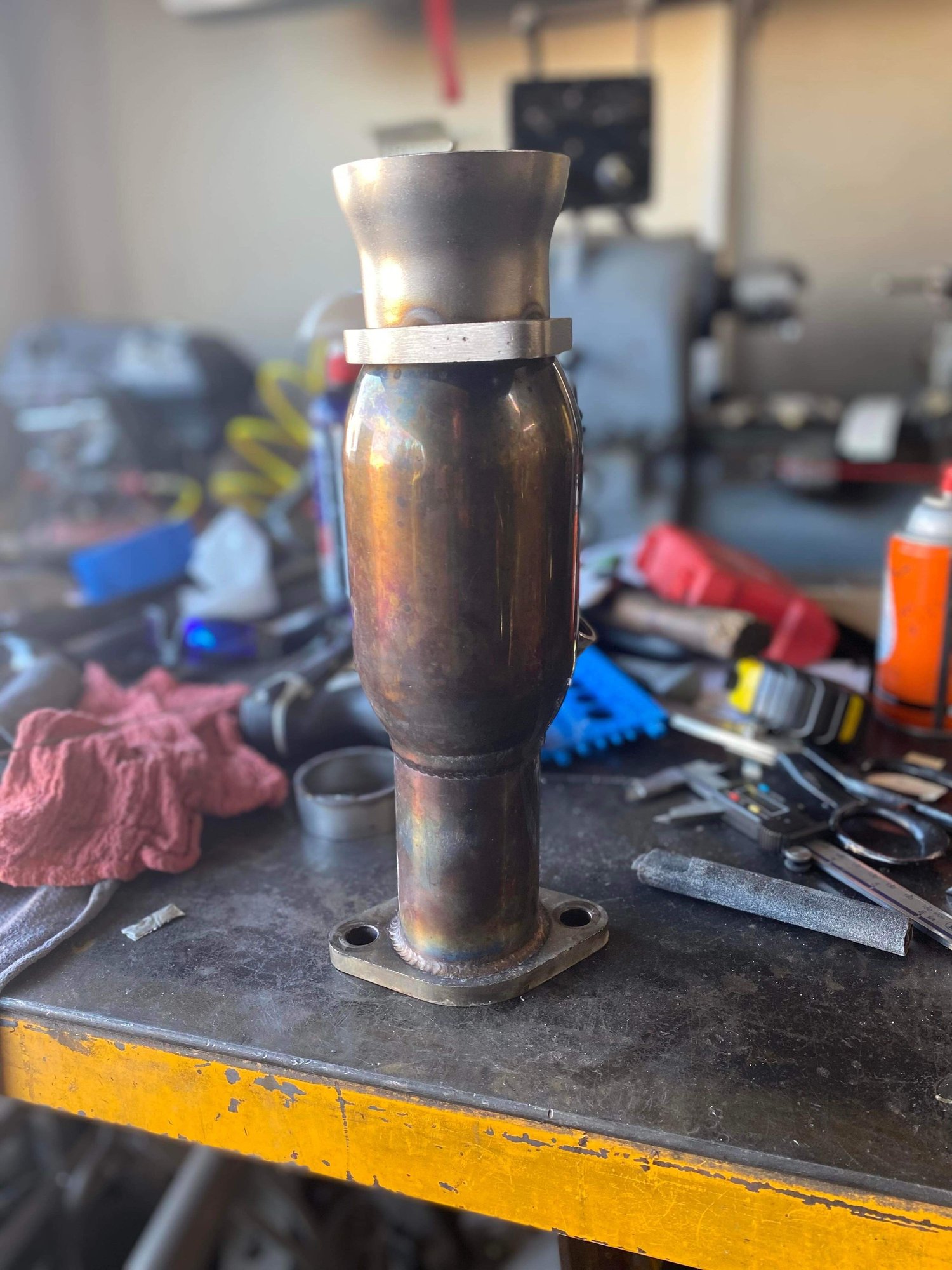

this is what me and my buddy did , we both luckily had “straight cats”
With one 02 bung
With two for afr readings
hope this helps
bolts directly onto my xforce
