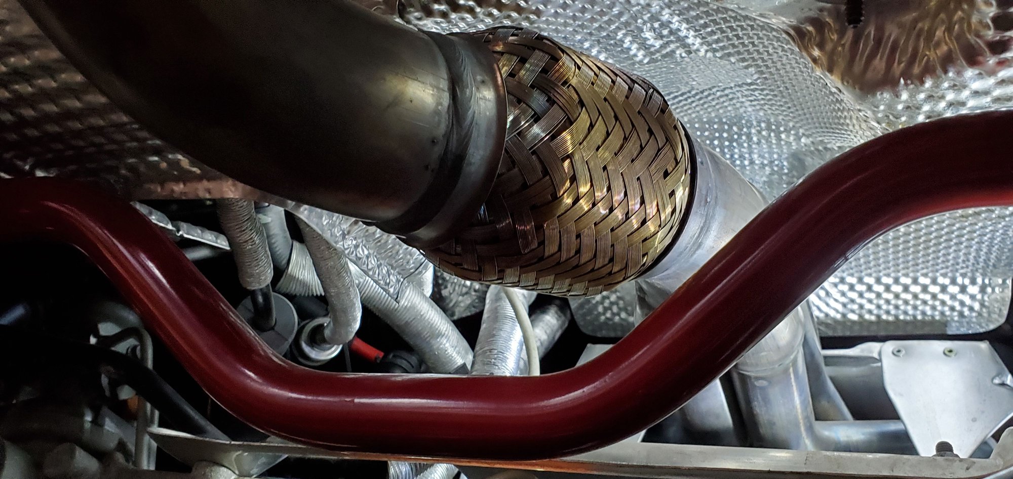

When outside and garage temps warm up later this week, I'll be switching back to Milltek non-res pipe to avoid direct contact with resulting resonant frequency transmission into the cab. Point being, you'd likely avoid that possible issue with an OEM header/cat...
Please clarify, i.e., is your Milltek resonator (or other exhaust component) making "direct contact"? If so, where? The problem I posted in January turned out not to be related to the 4-1 header with hi-flow cat flange position but instead, the B&M SSK extended box which was installed as part of performance mods when my car was new. As such, no room for roughly 5" diameter Milltek (or similar) resonator can there.
IMO, combo of stated header with non-resonated cat-back is too loud - at least for me. I ended up adding a Vibrant 4" x 18" OAL Bottle Resonator in the mid-pipe (pics in my sig topic) which helped a lot. I have a 2nd of same size ready to install in the Milltek non-res-pipe as soon as I confirm sufficient clearance to avoid contact with the shifter box (need 5/8-3/4" minimum beyond diameter of Milltek 2.5" pipe). As is now, sounds good around town and at level highway speeds but still too loud on local mountain grades.
I think he’s referring to the bottom of the pipe making contact with the exhaust hanger plate. This happened with mine and I ended up splitting the bracket in two, removing enough material from the middle that the pipe doesn’t have any portion of the bracket under it. Doesn’t seem to be a problem. I have a spare bracket in case I want to try hammering out a concavity on it to clear the pipe.
I’m not sure about the spacers though bc those hangers have a little portion that tucks into a small opening in the bracket. That part of the hanger wouldn’t fit in that little opening if there are spacers between the hanger and the bracket, but maybe that’s okay. But then I guess you’d need spacers for all the bolts that connect to the body as well.
