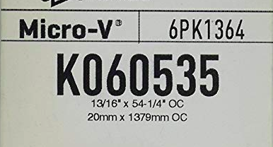

Quite confusing indeed ---
--- although the Gates does indicate 1379mm, that is for the OC = outside circumference,
so according to the label we'd say it's 1364mm because it states 6PK1364.

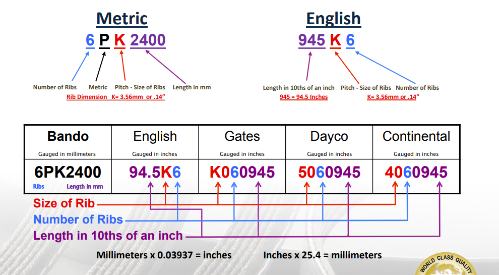

K060535 and K060539 are not stock --- they're both much smaller.
6PK1364 and 6PK1370 is so much easier to decipher for me as I never have like fractional measurements, and especially when it's in like 10ths of an inch!
K060535 = 1364mm
K060539 = 1370mm
Stock MCS size is 1388mm.
