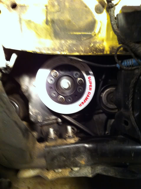

I just put the +2% ATI on the last weekend. Very nice piece!
Old vs New
Installed.
Nik
