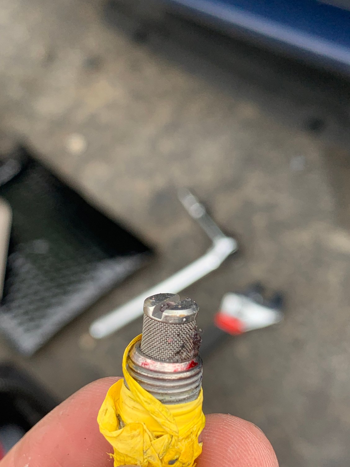

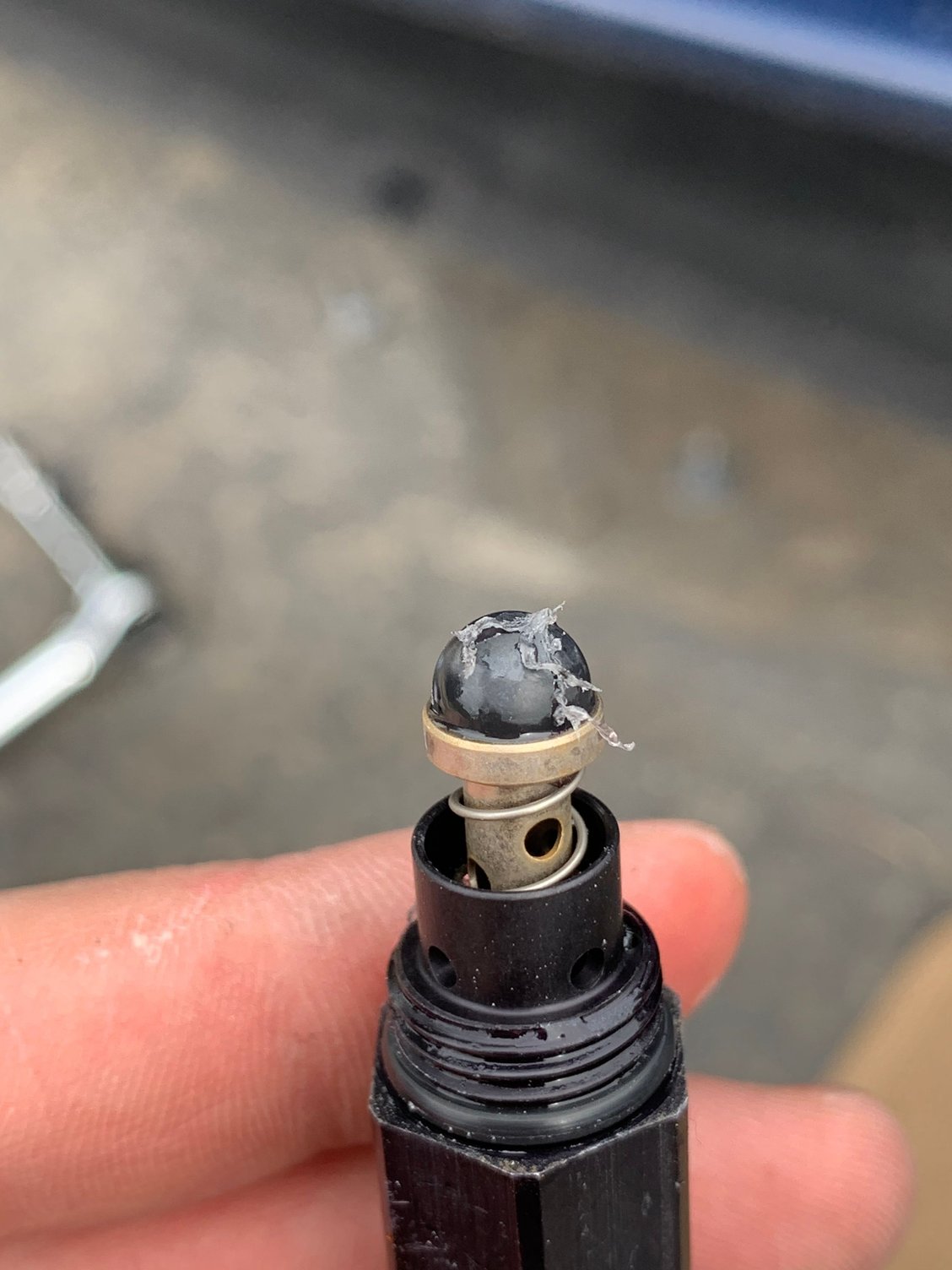

Make sure to routinely maintain your meth kit! I was battling misfires/rough idle and I could not figure it out.
Turns out I had a check valve failure due to debris. Check valve could not shut properly and meth passed through continuously.
This is caused my rough idle and stumbling upon acceleration.
Just FYI!
