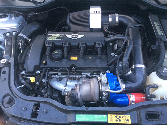

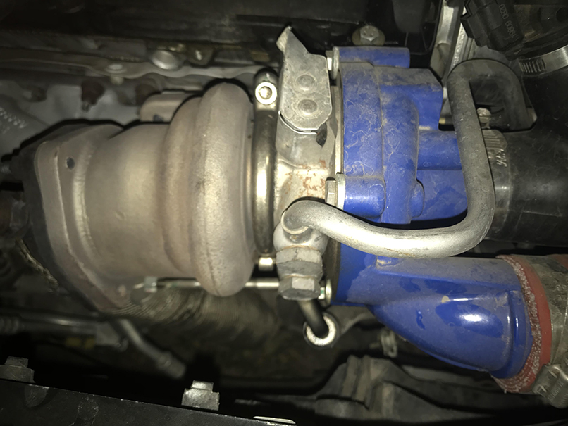

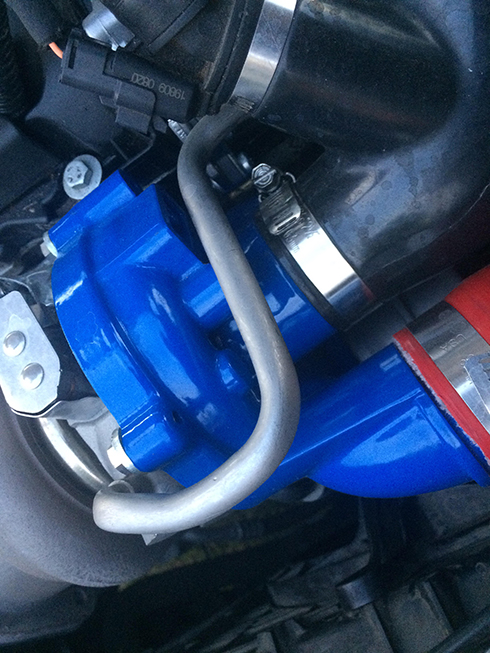

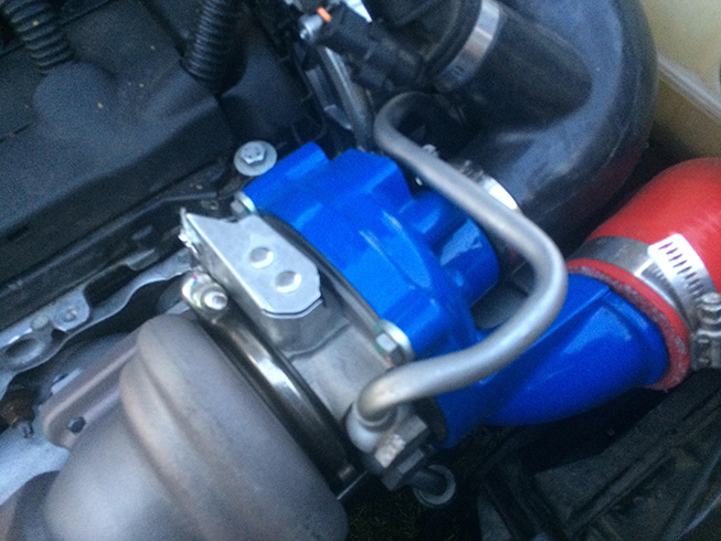

Do you guys have any idea which turbo I'm running here? The guy I bought the car from said it's a ported & polished BW, but I never learned what size. If it helps, it spools up to 21-22 PSI around 3000-ish RPM.

would really need to see the tag and any identification markings. If those aren't available you'd need to measure the diameters of the compressor and turbine wheels for starters.

Yes, the tag looks gone and someone painted it blue on the cool side, looks oem but might have a turbine/fin upgrade.

Just curious...did it come without the heat shield?

yes, i was just thinking that, hopefully you have the heat shield to put back I would not run without it. It will cook the valve cover front and possibly warp out the hood scoop even more.

Yep, that's exactly how it was when I purchased it. Where's a good place to pick a heat shield up?

Let me clarify, that's how the turbo was when I purchased the car. I think the guy that installed all the upgrades just failed to put that shield back on.

check out eurotechs on facebook, I'm almost positive i've seen that on their feed, unless there's several of these running around out there. they should be able to give you an idea of what it is

HA! Found the comment you were referencing, that's the exact turbo installed in my Clubman! Posted a quick reply to the former owner, should hear back before long. Thanks for the heads up!

you got it, let us know what you find out, also looks like turbo manifold is coated?
Thats the top factory sheild.
11657595605
https://www.ecstuning.com/Search/Sit...h/11657595605/
https://www.ecstuning.com/b-genuine-mini-parts/hex-bolt/07147543920/
07147543920 x5 is the bolts

Mystery solved!
So I was finally able to determine it's a stock turbo, just ported and polished.

Yes, from the outside it does look stock except for the blue paint. So that shield should work great.
