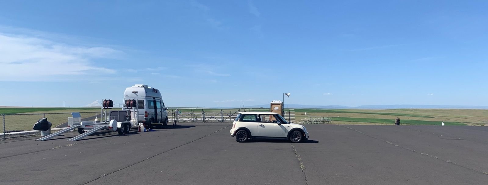

Reporting from the event site.
Desire didn't fall off the wagon on the Oregon Trail to the promise land
one notable car - a factory race prep GT350
remore control Mini
a cocky little car that can
this has to be the saddest cone in the world
One of Desire's diet is bugs; oh, we dodged Kamikaze birds too on the track

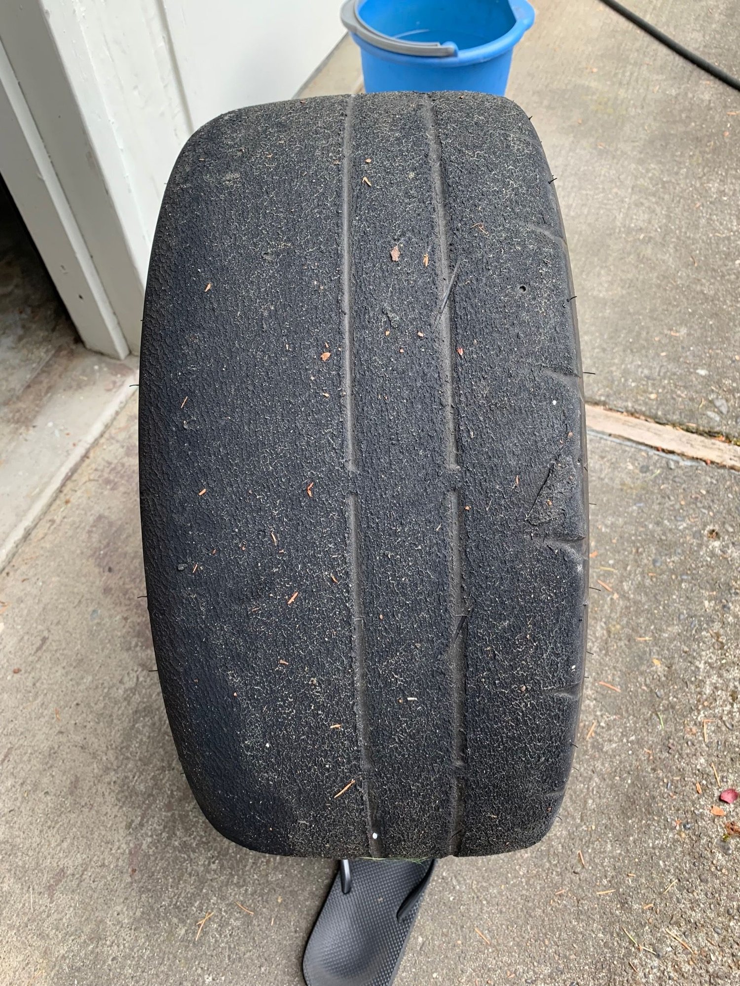

I used the new pyrometer after a couple of sessions. It is indeed a nice product that is easy to use and most important extremely low thermal mass. I use iPhone's voice recorder to record the 3 measurement of each tire by calling out the temperature. I then transcribed to paper. I was expecting the outside threads to have the highest temperature but to my surprise they are not.
I am also very happy the set of Nitto NT01 has survived three long track days so far, though I would leant from a Miata owner the highs and lows of this tire. Good thing to know is there are tires that can cut 8 seconds a lap. The supercharged ND Miata is very fast and one of the best drivers of the day.
left front
right front
right rear
left rear

So the Nitto NT01 lasted 4 long track days and has not corded yet. I am amazed how even they worn, that now I don't scrub them needlessly. Both rotors have multiple cracks and the ST-41 pads are shot. That's what you get on the Min running with some very big boys. M3s and Desire was on the tail of a GT3 RS for 3 laps. She even intimidated the Porsche in many turns. A lot of these cars are running slicks or very spendy tires and suspensions.
This track is so hard on everything because of the constant elevation changes. Each lap has 400 feet. All these are serious prep'ed track cars. We were just hammering on the brakes and the poor clutch too took a beating, as well as the Quaife got constant workout. I have been maintaining or back off the throttle less rather than lift while doing left foot trail braking. I even use left foot braking at some turns that require hard braking before turning in. The left foot is trainable old dog.

more photos from the track event
When I drove at PIR my constant wish was let's hope there would be less cars in the run group. I thought becoming a member at ORP will be heaven for all you can eat driving any time you want, pass everywhere, and much fewer cars and nearly no newbies. All are true except I now realize it can be very boring when you have the whole track to yourself very often. We had just 11 cars the first day, and 6 cars the next. And my Miniac that have been driving this track for close to a decade has not been driving this track yet this season.
Desire got a new nose ring; there is already one on the dirty butt
as promised we brought spare parts for the front brakes
our team arrived to the event site the late afternoon and unloaded Desire; the ran carts that day and would have been entertaining to watch; I also thought would it be nice to switch to carts for less damage to one's finance and mental stress
the new wheels with Toyo R888R; and we brought 6 jugs of fuel this time

Is this under warranty? Both front rotors are like this. This left front has two radial cracks the go right through across. I could really feel the pad catching initially until the rotor warmed up and got smoother. Then it braked like all is well so I drove until the bitter end.
doesn't look that bad really
this in hardly worst
the bloody mess left from the punctured CV boot
this is the first time my tires worn this evenly across the width
