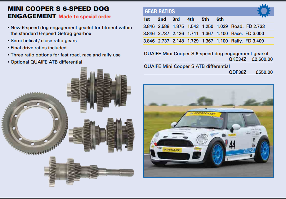

Originally Posted by pnwR53S
Back on topic on the recent exposition on dogbox for R5X Minis. As I infer one can convert the Getrag 6 speed that lacks the bloody proper straight cut gears musik (like the Midland 5 speed) with some aftermarket conversion kit. I suspected Quaife has something for it. Strangely surveying thru their gearbox kits there is nothing under Mini or BMW. So I check to see if they have something for Found On the Road Dead, and they have Focus and Focus 2.
I wonder if one of these is for converting the Getrag R5x box. A quick email to them will answer the itching question only if I am convinced 3415 diminishing Britcoins is a worthy investment. The Brit vendors had always been a pleasant bunch to intercourse and were generally receptive from my limited experience.
They used to have a MINI-specific gearkit available but I think it's no longer in production?
It weren't proper straight cut gears though,
bloody semi-helical...
Found that in the 2011 catalogue,
pdf:
https://s.race.fi/data/quaife/quaife2011.pdf

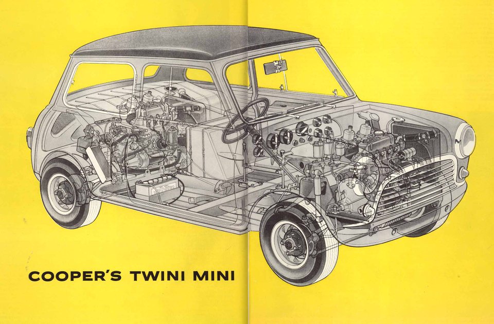

...another route is the twin engine:
Pretty neat but I'm sure it took lots of fiddling to get sorted.
Also neat because it plays into the whole heritage aspect because there were some Twini Coopers back in the day.
A good article here:
https://www.classicandsportscar.com/...tested-in-full
It nearly killed John Cooper when he crashed one.
While looking up the old Twini I came across the Lane Motor Museum who has a replica on display,
it looks pretty wild with the double shifters:
https://www.lanemotormuseum.org/coll...i-replica-1965
I didn't realize how close I was to that museum,
I gotta go visit!
