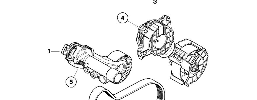

I would bet it is the belt tensioner or the friction wheel.

I will check it out. Not sure if that will be it or not. The car didn't make that noise when I shut the car off to do the oil cooler, but it did start on the next start up after the install.
I double checked all my work so I am almost positive it was not an install error.
I am thinking it could be the oil pump. Maybe the cooler is making the oil pump work harder?

So you're saying it doesn't go away when you rev up the car or start driving? You might want to get under the hood with a probe and start listening to things to try and figure out where the source of it is coming from. Maybe your friction wheel? Not that this is your problem, but the pulley or the pulley bearing can become noisy, causing a high pitched squeal or scraping sound when the engine is running. Just a thought. We have an article here that goes over it with more info and figure 2 gives you an idea of how to maybe test it. May not be your issue though... Maybe you can post a video of the sound for us?

well, its not the friction wheel or tensioner. any other ideas?
