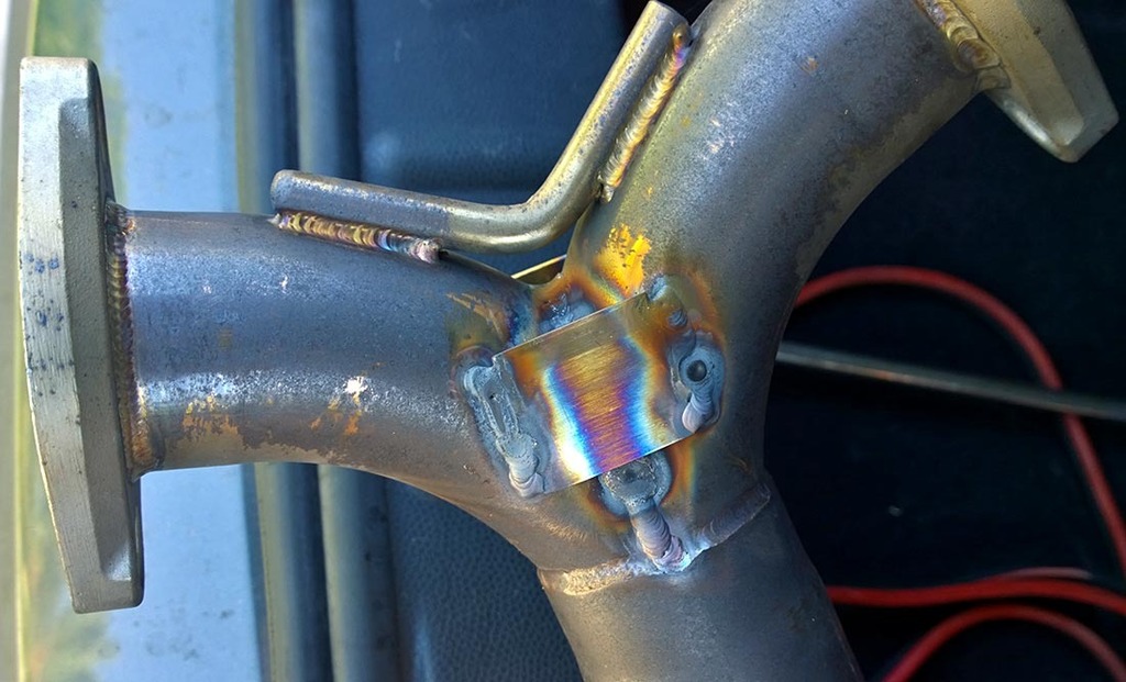

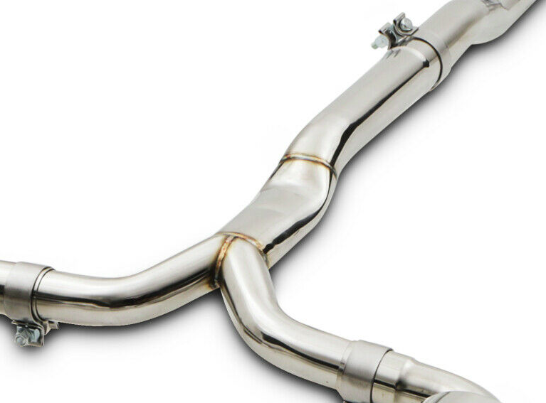

And... After just 10k street miles a huge crack at the Y-pipe.
I had a welding shop fix the crack and add some reinforcement. Hopefully I can get a few more months out of it while I save money to have a custom exhaust made.
So in conclusion, This exhaust has a great tone and sound, it looks like a quality exhaust when you open the box, but it is junk, like something you find on ebay for really cheap type junk. My advice is spend your money elsewhere.

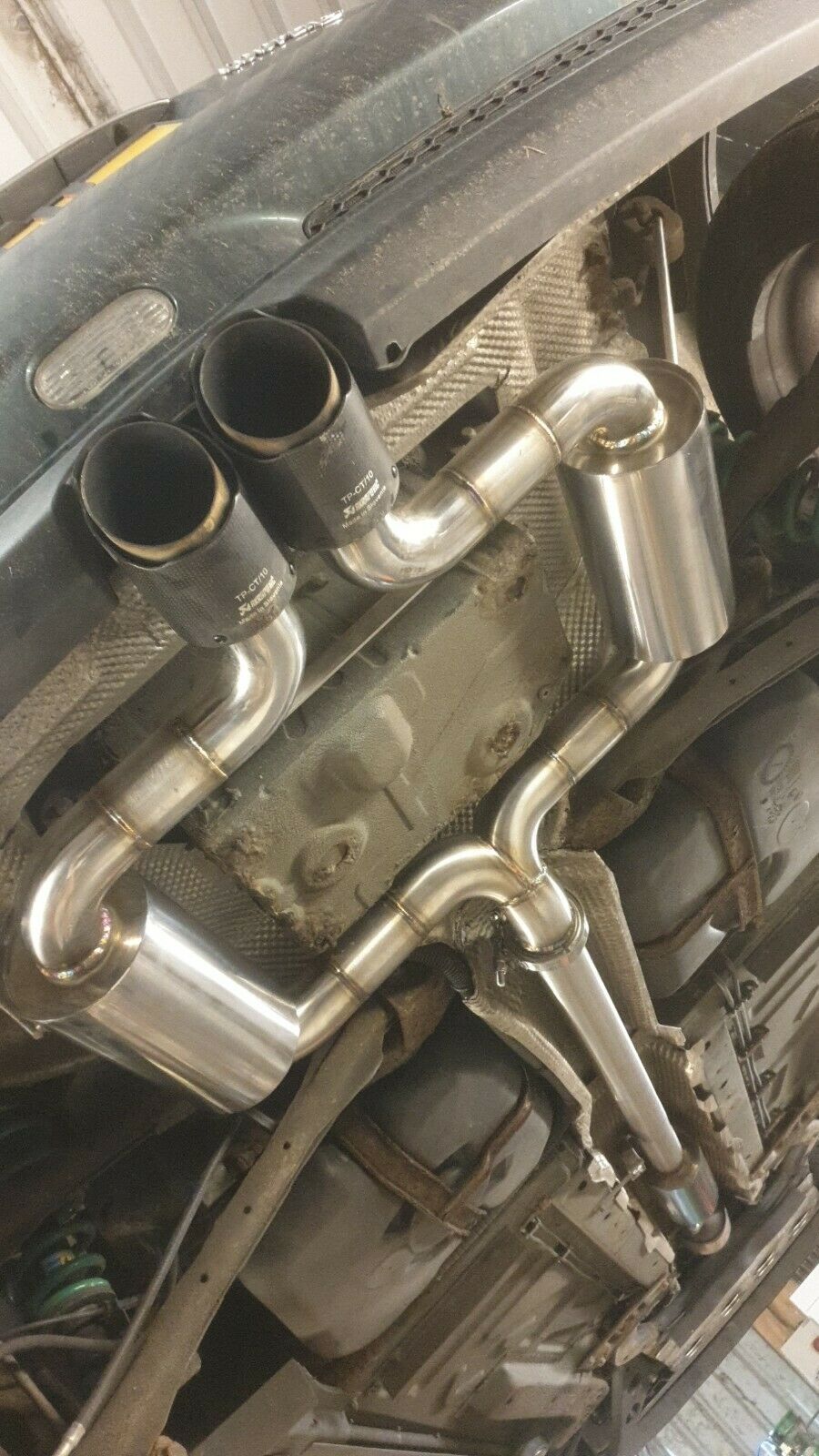

I had the JCW system and bought an aftermarket system (Gravity Performance) and it was a big difference. The JCW exhaust is civil and the Gravity is quite a hooligan (without overdoing it). The Scorpion header will probaby make your car a little louder, but the JCW system will still muffle it. A stainless catback is the way to go, you will not be dissappointed.
I made a video for my exhaust, which has a little bit of a comparison with the JCW exhaust. Also I have the stock downpipe with cat+precat.

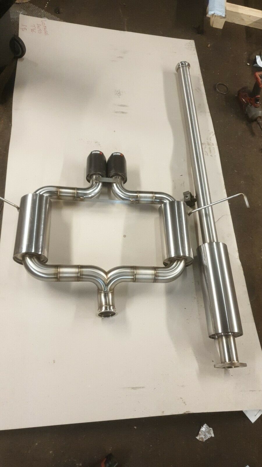

One aspect of the Gravity design that I don't like is that they copied the squashed section same as factory JCW...
...whilst browsing ebayUK came across this one from DND which would likely be quite loud, but it is appealing to me and appears to be well made,
but cost-wise it's around the same as a Milltek and I'd rather not gamble on an unproven system.
https://www.ebay.co.uk/itm/133699410...6&toolid=10001

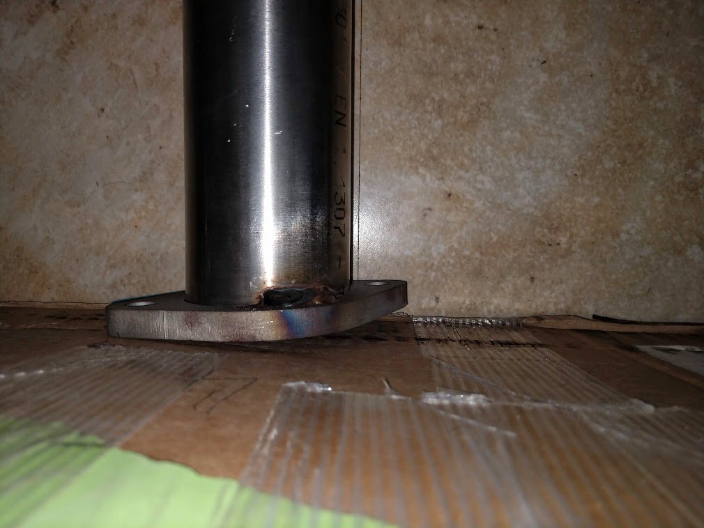

Well, it came in today...
...but I'm concerned that perhaps the front pipe is eff'd up because the bracket is crooked and when stood up it leans like 15° or something,
definitely not straight.
It should be straight right?
Hard to get a good pic showing it,
but here it is against a box and you can see:
Any help much appreciated.
Is this normal? Are they designed this way?
I do not want to encounter any headaches during install.

Why is there only a weld in 1 place on the collar? I believe it should be straight though...
It should look more like this

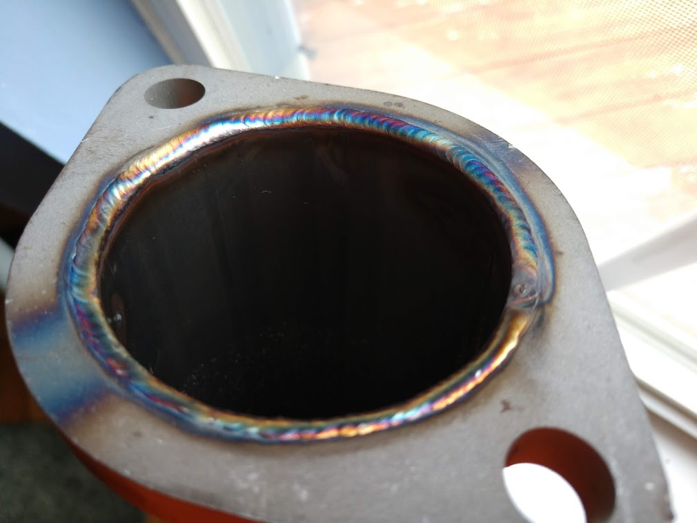

It is welded on the inside.
I have emailed Milltek and await to see what they say regarding the angled bracket on the mid-pipe.
Seems like it should be straight yes?
No guarantees here, but I seem to re@pnwR53S encountering this as well. IIRC, it's a feature, not a flaw, but if you want to do an advanced search on his epic tome of a build thread, it's in there.

Well,
he got it sorted.
Looks like it is actually designed that way.
pnwR53S wrote:
"Having received two sets of the Milltek cat back with the same flange on the long main pipe segment have the same off-square made me suspicious. I got up at 2:30 AM to call Milltek in UK. The person the phone said he is not technical and asked that I get a photo of the ID tag of the part in question, and he will relay the issue to the right person. The ID tag is the small welded on stainless steel plate with part markings. Every piece of the Milltek kit has a unique ID tag with "Made in England" etched on it.
I went back to bed after making sure Leigh has everything he need to follow up. By the morning Leigh has reply with the answer with an email. It as sent within a few hours of our last correspondence. I was impressed with their responsiveness.
He had checked with their production team who checked their master pattern, and the off-square angle of the flange is apparently normal, which I interpret it is as per designed.
The next day I decided to go ahead and give the installation a try to see if everything "square up". My original hangup was the ~7 degree of offset angle will skew the main pipe to one side instead of well center in the exhaust tunnel, and possible push the O2 sensor against the aluminum heat shield.
It turned out the ~7 degree offset is mainly vertical component, with no measurable horizontal component. Being only vertical component it is absorbed by the stock header's flex joint. I was able to reuse the stock gasket that consist of a ~1mm thick stainless steel sheet metal. When all the joints (there are 3 in total) are properly tightened the long main pipe sits perfectly center in the exhaust tonnel. It is also horizontally true as well as long as all the exhaust shock-mount hangers are in good condition.
My other hangup on the Milltek's hanger bars lacking the nubs turned out to be immaterial, as least with my specific unit. Once the three joints are properly tightened the muffler assembly is rock solid with respect to the Mini undercarriage. If I grab onto the tail pipes with my hands I cannot wiggle them in any direction due to the excellent (6 point support) hanger systems of our Mini.
I suspect Milltek chose to not adhere to the interface boundary (maintain a perpendicular plane of the flange) of the stock header was done to accommodate their own header, for whatever reason. To this accept as the cause of my original concern. Now seeing the installation result I am satisfy that it is an excellent product I retract my charge of shoddy workmanship.
I chose the Milltek over other competitions because of the one-piece muffler assembly design, country of origin, and price. Seeing how driving on track can beat up an exhaust system I did not want the Borla that has too many joints. The Stratmosphere appears to be very high quality, and most alike the Milltek and with the nubs on the hanger bars. It is however priced much higher. In all I am now quite pleased with my purchase."
"I did not take photo of the front flange joint. It mates tight with stock 1mm all steel gasket so there is nothing to see there. The stock header just had to unbend that slight angle vertically to absorb this angular difference.
I was concern with the rear flange joint and prepare to widen the heat shield there to gain more clearance. It turns out I didn't need to."
"I think Milltek did not designed in this slight tilt without a very good reason. If you look closer at their product photos you can see the long pipe flange do have the slight tilt."
"I think they did this to accommodate their header which is reported to only header with a high quality German cat. They engineer must deem this bend necessary on how their header to fit the best it can without exceed the bending range of their flex joint, taking into account the max engine rocking range."
When shopping for a performance header, most people would overlook a detail. It is if the feeder pipes would all be shielded by the stock heat shield that attached to the cylinder head. From this photo I can tell the Milltek does, but not a lot of other headers that I have browsed."
So that makes me happy.
Milltek should have some sort of basic installation sheet that denotes the tilt, because it is rather alarming and makes you think it is fugged up.
